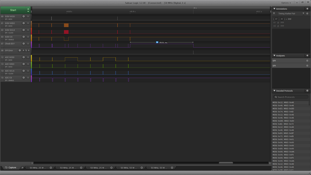

For debugging purposes, I have two GPIO outputs:
SPI_COMM_1 is toggled at the beginning and end of SPI_CheckFlag_BSY(). This GPIO is labeled as Check BSY in the logic analyzer screenshots below.
SPI_COMM_2 is toggled within HAL_SPI_ErrorCallback(). This GPIO triggers my logic analyzer capture, and it's labeled as SPI Error in the logic analyzer screenshots below.
The behavior that I'm observing is that the SPI_CheckFlag_BSY() function will randomly return with an error (timeout) after a transaction on SPI 4 (slave). I'm using the HAL_SPI_TransmitReceive_DMA() function to setup the SPI 4 transfers. All peripherals were setup using the CubeMX (including FreeRTOS).

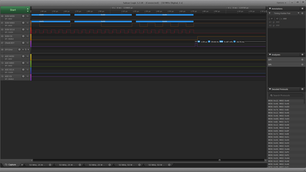

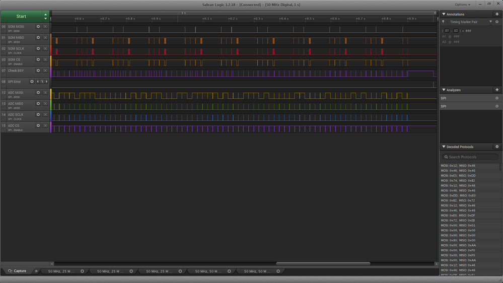

As the screenshots below indicate, neither SPI 1 nor SPI 4 is busy with any transfers, yet the SPI_CheckFlag_BSY() continues to busy-wait for roughly a 100 milliseconds before returning with a timeout error. Most of the time, it only busy-waits for as little as 1.5 microseconds up to 41.5 microseconds.

Overall capture (noting SOM SPI signals on top, ADC SPI signals on bottom, and debug signals in the middle, with SPI Error acting as the trigger for the logic capture).
Zooming in on a typical wait (1.5 microseconds)
Zooming in on error frame (Noting the 100 millisecond wait as well as the lack of activity on both SPI 1 and SPI 4 buses)

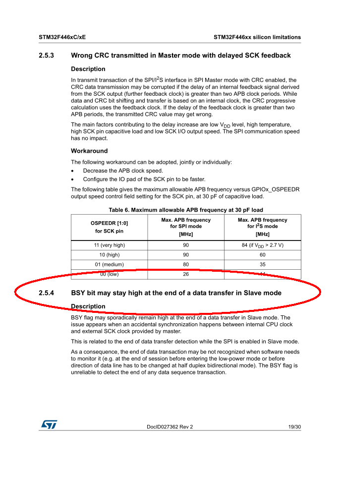

Yes, it's a known - and very unpleasant - hardware bug in the SPI module:0690X000006COSbQAO.png
Thank you!
Are their any known workarounds to this problem?
Workarounds are described in the Errata document. It's probably up to you to implement any known workaround in the HAL code.
I see. Yeah, I read the workarounds in the document shown above. But as you predicted, I was hoping for a HAL-specific workaround.
