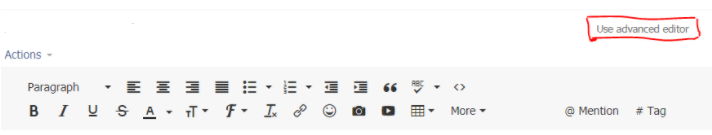

Hi ,
When
you reply to the post, please
click on ''Use advanced editor''
link at the top right of the editor window:
Then, you can click ''Attach'' to add your file :
Kind Regards,
Imen.
