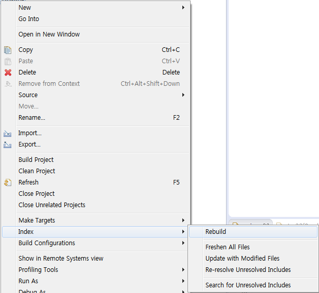

Right at the moment, in AC6+Eclipse environment, the build error shows,( just showing 1 similar error)
C:/STM32_toolchain/common/Drivers/STM32F0xx_HAL_Driver/Inc/stm32f0xx_hal_adc.h:238:2: error: declaration for parameter 'ADC_HandleTypeDef' but no such parameter
}ADC_HandleTypeDef; ^At this time, stm32f0xx_hal.h andstm32f0xx.h added by # in stm32f0xx_it.c ........ and indicating red underline.

‎2016-12-27 2:12 AM
Hi
Hasan.Md_Mubdiul
,Could you try to rebuild the project using: 'Right click on the project -> Index -> Rebuild'.
Give me your feedback.
Khouloud.

‎2016-12-27 5:17 PM
Hello Mr Khouloud,
Thank you to respond here.
Don't you mean the following way?...
This process does not change anything, CDT build log is empty !
