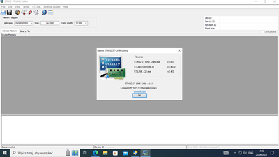

Kindly provide me the latest Firmware version for the above-mentioned Product along with the necessary instruction to upload it using STM32 ST Link Utility.
We are currently getting old firmware issues screenshot attached
Please assist us regarding this at high priority.

I have utility already installed on several computers in my automation line along iwth this nucleo hardware
Could you please just help to update the firmware version thats all

STM32L152 Nucleo-64
STM32 ST-Link Utility.exe V3.8.0
ST Link USB Driver.dll v4.4.0.0
ST Link_CL.exe v2.4.0

To upgrade the ST Link FW you need either to to use STM32CubeProgrammer or ST-LinkUpgrade utility downloadable from here. There is no other solution.
As stated above ST-Link utility is obsolete since a while and no more supported.

You only need to update the ST-LINK's firmware on one machine.
What error specifically are you seeing and what firmware version is on each of the ST-LINK's
The stand-alone ST-LINK firmware update tool can be found here.  https://www.st.com/en/development-tools/stsw-link007.html

If you have STM32CubeIDE, it will do the update automatically ...
