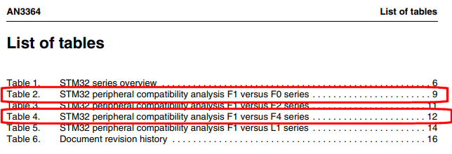

Doesn't combining Tables 2 & 4 give you F4 vs F0:

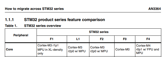

See also Table 1;
Going from F4 to F0 is a "downgrade"
"Doesn't combining Tables 2 & 4 give you F4 vs F0:"
Sort of... :smiling_face_with_smiling_eyes:

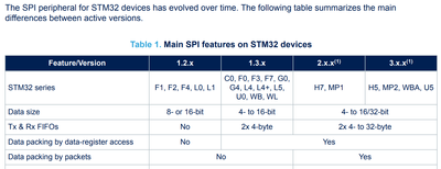

Another example, I know the SPI on the F0 and F4 are different, as the F0 uses version 1.3 of the SPI peripheral, rather than the 1.2 version in F1 and F4 (as described in AN5543).
This is covered in the tables, and can be understood, but only because the F1 and F4 are fully software compatible (hence I assume they operate the same, but are de-featured at the lower IC):

@###### F0 is newer than F4 by release date, this explains that its peripheral IPs are newer. But its CPU is M0 (not even M0+) compared to M4-FPU of the F4.
