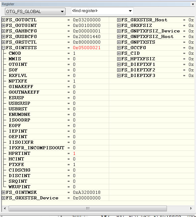

andrea6388
Posted on September 20, 2016 at 13:15
I also attach a screenshot where I show the interrupt register: it seems it's the HPRTINT interrupt that is occurring but no library function manages it.

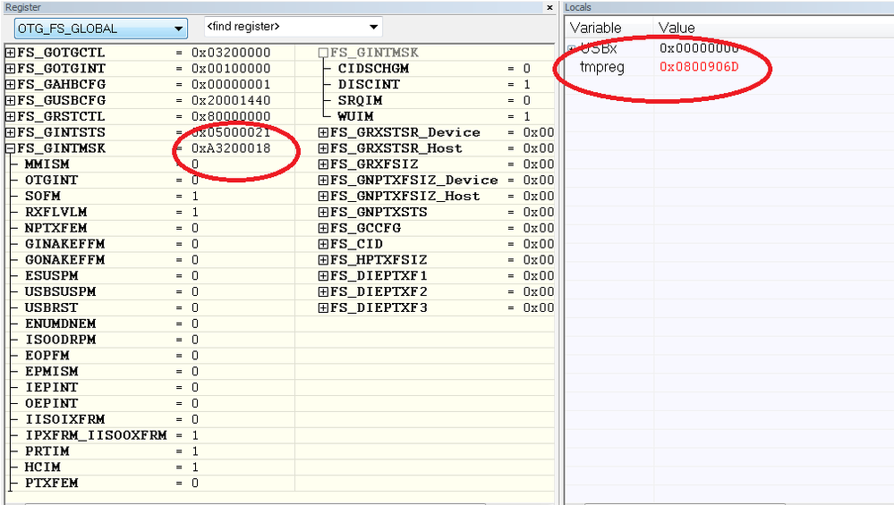

andrea6388
Posted on September 20, 2016 at 13:32
It seems I got it...
the function that chooses between interrupts seems to do not correctly interprete the connection interrup HPRTINT...
More correctly the values that I see from Registers tab in IAR debugger do not agree with value assigned by the function USB_ReadInterrupts:
