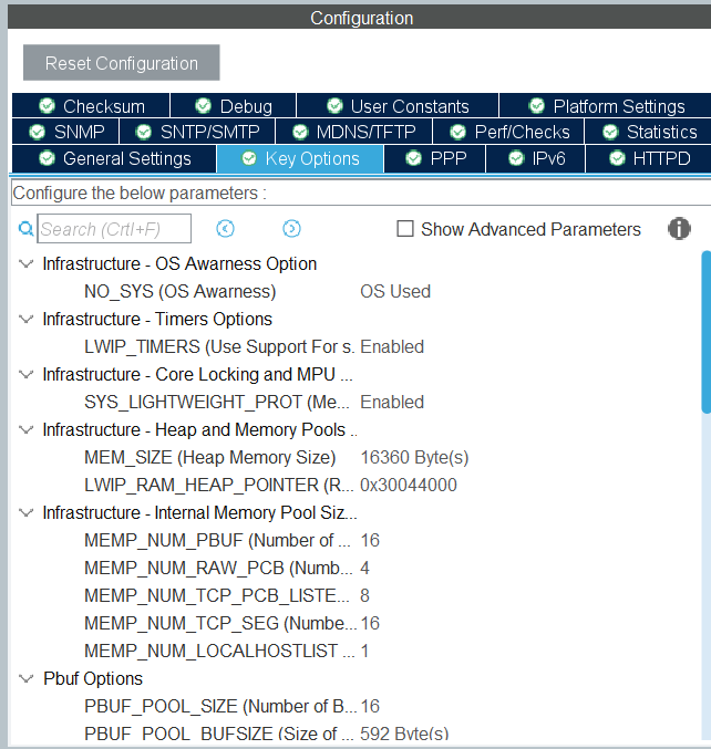

I am working on KSZ8563 3 port ethernet switch. I can communicate with KSZ via MDIO but Lwip udp example is not working. Controller is STM32H753ZI.
example link :
https://community.st.com/s/article/How-to-create-project-for-STM32H7-with-Ethernet-and-LwIP-stack-working

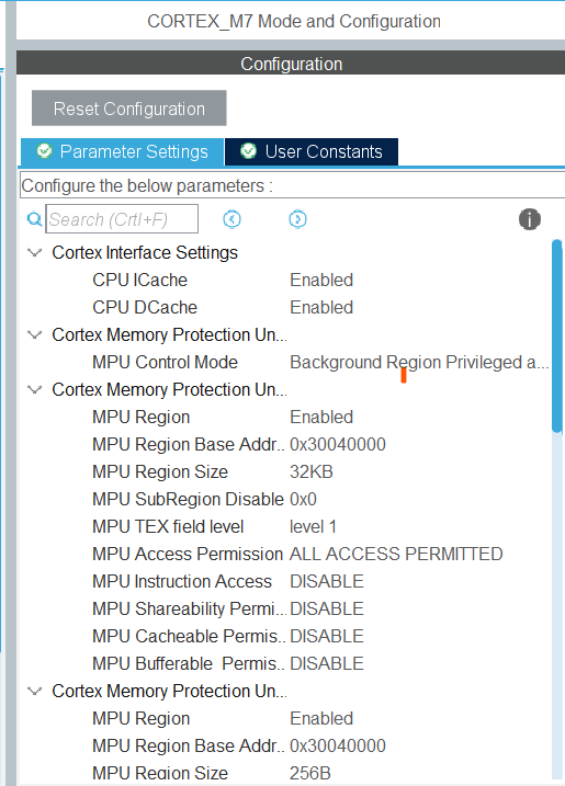

1-Mpu Configuration:
0693W00000DqMm3QAF.png2- Ethernet Global interrupt is enabled
3- Lwip Configuration:
0693W00000DqMo0QAF.pngLWIP_NETIF_LINK_CALLBACK enabled.
Also I atteched linker script.
After these settings, i reset the KSZ (Hardware reset) and ı reach the basic control register of phy via MDIO. After soft reset for Phy port 1 and port 2, udp example code is running (above example link). But unfortunately ther is no communication.
Looking forward to your advice.
