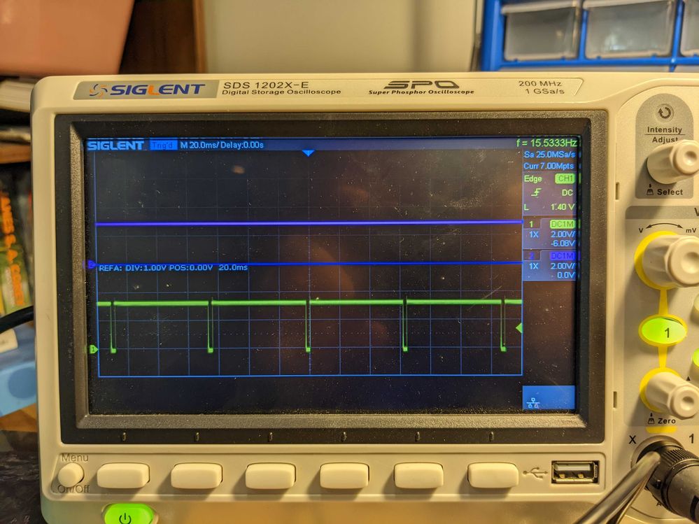

The Question (since this is a little long): Is there any known interaction between the WWDG timer and the bootloader located in System Memory? Is there any known differences in the F405 revisions that could have an interaction between the WWDG and bootloader?
Hello, I'm working on a product that receives updates via the DFU bootloader. I have two batches of the same board received from the same manufacturer, and one batch is behaving strangely as I attempt to use this method to jump to the bootloader.
The code is based off of this tutorial, and works flawlessly on older batches of the board.
However, on a new batch, instead of jumping to system memory for DFU upload, the board will simply reset from the WWDG IRQ. The overall program feeds the WWDG every couple milliseconds, but by the time the program calls the SysMemBootJump() function, it should have disabled the RCC timers and the WWDG interrupt.
In order to demonstrate the issue, I'll attach a sample project I made in CubeIDE that produces the issue. The program will start with a GPIO set low, and after waiting for short period, will set it high, then jump to the bootloader. On the affected batch of boards (the bottom signal) the GPIO line will dip, indicating a hardware reset. The top signal is the a board operating normally, holding the GPIO high while it waits in system memory:
0693W00000WJSWaQAP.jpgThe only difference between these two boards is the batch number of the STM32F405RGT7 itself. The normal board has the following manufacturing information:

It's pretty easy to dismiss this issue as a difference in the two batches of PCB, but I have been able to verify that the normal operations of this part are meeting expectations, it's just this WWDG/DFU situation.
Related Behaviours:
  • The affected board will boot to sysmem and allow DFU if the board is powered up and BOOT0 is pulled high
  • Explicitly disabling the WWDG peripheral clock (RCC->APB1RSTR &= ~RCC_APB1Periph_WWDG) before disabling interrupts via CPSID/__disable_irq() will allow the board to jump to sysmem
Other things I've checked:
  • Greymarket clones: chips sampled from the affected batch have unique chip ID values and internal serial numbers.
  • ARM revision: both affected and unaffected chips return 0x410fc241 from the SCB->CPUID register.
  • Wonky clocks/resonators: the boards are driven by a 25MHz external oscillator, and part of the program drives a PWM (on TIM1) signal at 533kHz. If there was a difference with the resonator the PWM signal should be affected, but it is not.
  • Running the same test code on an unrelated part with a similar processor (an STM32407VGTx): the F407 behaves the same as the "normal" F405
