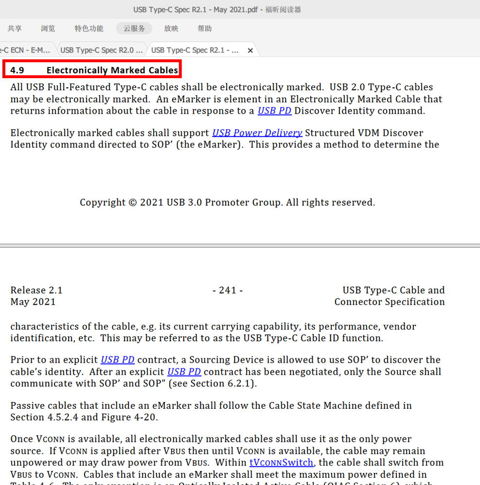

Is there any source code about e-mark cable?
DLi.2
I didn't find any information about e-mark cable in the link below, Have ST developed the code for the e-mark cable?
st.com/content/st_com/en/ecosystems/stm32-usb-c.html
2 REPLIES 2
Andrew Neil

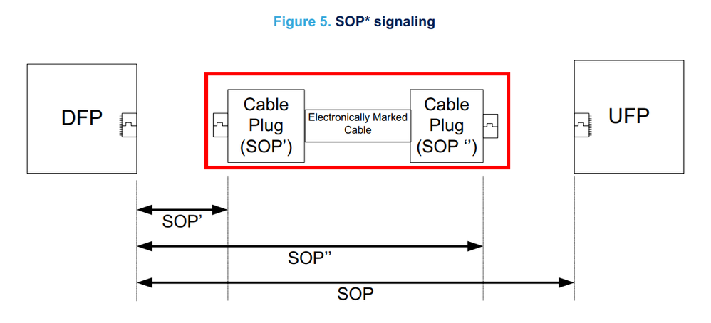

You mean this: https://www.pshinecable.com/article/What-is-an-E-mark-chip.html ?
Yes, Emark communicates with the host via SOP‘.
