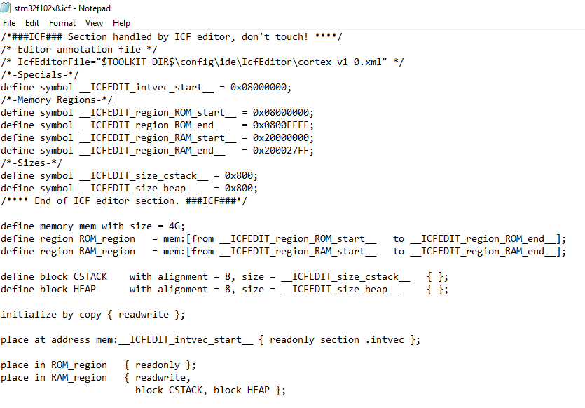

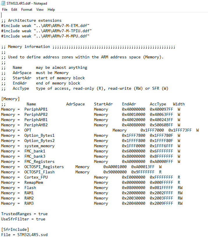

Now that your request seems more clear and looking on the example you gave me, I can think may be some files from the IDE EWARM (IAR) can help you. In fact from your example you need the Flash and RAM division predefined for different stm32 products right?
- My first proposition is the linker files under IAR install (.icf) that contains the rom/ram memories defined by start and end addresses (see below an example)
- A second more detailed proposition is to use .ddf files with more detailed view of memories (see below)
I believe it will be up to you to define a script to extract the infos you need which don't seem like a complicated task!
Let me know if this solve your problem?
Imlen

Hi @Imen Ezzine​ ,
.ddf files looks better to me, for two reason, first they seems easier to parse and second if they are form ST and I'm allowed to redistribute them in an open source project that would be awesome.
The only limitation I see here is that I might have to do some guess to find which RAM is CCM RAM, but that should be ok.
Where can I get ddf files?

‎2020-09-18 2:18 AM
Hi AJean.1,
In fact these files are part of ST deliveries for the flasher support, then these files get integrated within the EWARM workbench IDE, so I believe you can find more about the License limitation via this link: www.st.com/SLA0044
I advise you to download the latest version of EWARM (IAR) IDE in order to have access for the latest supported stm32 products. And you will find the .ddf files under a similar path in your C: directory: Program Files (x86)\IAR Systems\Embedded Workbench 8.4\arm\config\debugger\ST
