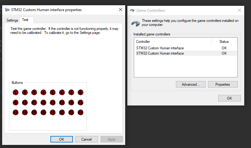

Is it actually Possible to define multiple distinct HID joysticks on one interface? I have Nucleo F439ZI Board

first of all, having 2 configurations won't solve your problem. As mentioned in the training, configurations are used for different "power modes" of the USB device. What you need is to have 1 device descriptor, 1 configuration descriptor and 2 interface descriptors (assuming you are going the "composite device way").
If you are using ST Middleware, you need to change interface descriptors in usbd_hid.c file, and also other functions, e. g. for reporting and enumeration of the device.

yes, this is possible either with multiple HID Top-level collections (if you mean under the term "interface" the logical USB interface) or with a composite device (multiple USB interfaces, but still one device = one HW interface).

thanks, actually i have configure my nucleo board as device and pc as host and created joystick controller interface. now i have to do multiple joystick controller with one device.
can you help how to send my data from device to pc as host ??
