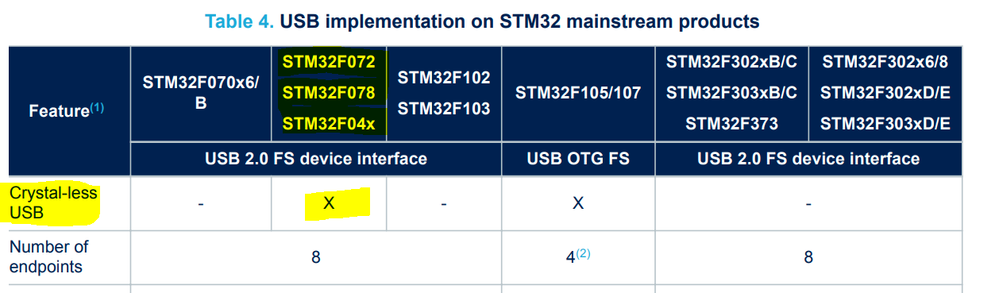

It is recommended to keep USB clock within specification. Without it you risk issues of connectivity related to temperature, or host system implementation. ie difference in clock offset between host and device exceed tolerances.
See if it is a check-box item for USB Certification
Some STM32F0 chips support crystal-less USB. Otherwise you need a crystal to adhere to timing requirements.
https://www.st.com/resource/en/application_note/dm00296349-usb-hardware-and-pcb-guidelines-using-stm32-mcus-stmicroelectronics.pdf
SSing.10
Ok I can see some STM32 MCU are having internal USB oscillator.
Please confirm and correct me if I am wrong in getting proper configurations & settings, I am currently using STM32F730V8T6 so does it require external oscillator for my usb related operations.
Please confirm me for the same.
The STM32F730V8T6 requires an external crystal to satisfy USB timing requirements per the datasheet.
SSing.10
Hi @TDK​ ,
Thanks for confirming the crystal requirement for STM32F730V8T6, I have assembled and it works.
