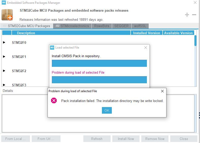

Installing the "en.x-cube-azrtos-h7_v1-1-0.zip" fails
LHede.1
 I keep getting the message "Pack Installation Failed. The installation directory may be write locked."
I have full administration on the PC (Win 10) and plenty of space, so...??
Appreciate some advice.

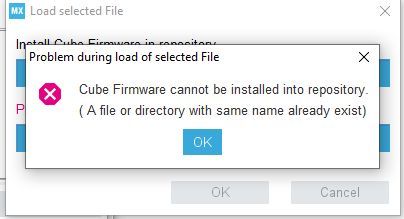

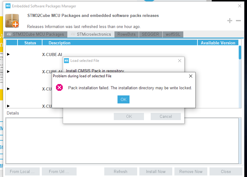

I have the same Issue and can not solve it. It is impossible to install the packages I get this error:
This is the message for the second package:
0693W00000DnwwNQAR.jpgThis is the error for the first package
MThom.6
I solved it by copying the packages by hand into the folder
C:\Users\USERNAME\STM32Cube\Repository\Packs\STMicroelectronics
Also I disconnectet the computer from our office net and connectet it directly to an internet router.
