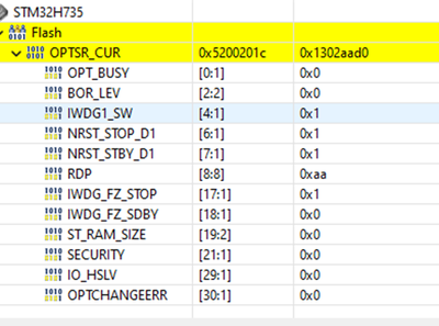

Option bytes seen at Cube Programmer:

At CubeProgrammer it says: "Unchecked: independet watchdog is freezed in STANDBY mode. Checked: Independent watchdog is running in STANDBY mode".
I want the independent watchdog to be freezed at standby mode.
I have checked corresponding reg and it is set to 0 which acoording to RefManual:
"Bit 18 IWDG_FZ_SDBY: IWDG Standby mode freeze option status bit
When set the independent watchdog IWDG1 is frozen in system Standby mode.
0: Independent watchdog frozen in Standby mode
1: Independent watchdog keep running in Standby mode."

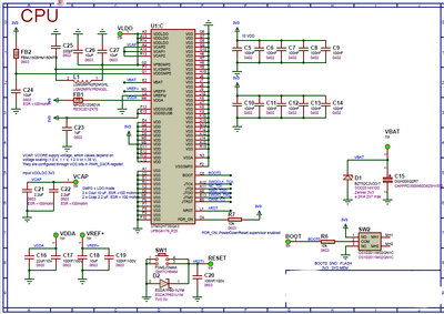

I am using a custom pcb and configuring power mode SMPS + LDO.

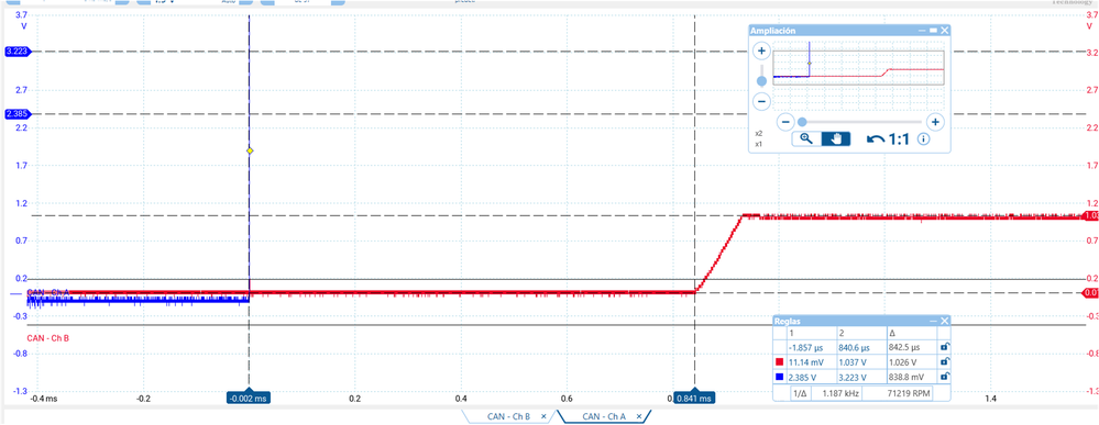

 When my sistem enters Standby mode and i see Vcap = 0V (while VLDO remains ~2.4V).
At standby mode, after 842us of activating the wakeup pin i have configured (blue signal), Vcap starts raising to 1V (the voltage raise to 1V time is 86us), but it seems that the core domain gets lost at this point (no program starts and even not any hardware reset can get the mcu out of this state, just powering down and up the hardware gets the mcu out of that state).
Some interesting context for the issue:
I am using a custom hardware:
I am configuring:
HAL_PWREx_ConfigSupply(PWR_SMPS_2V5_SUPPLIES_LDO);
