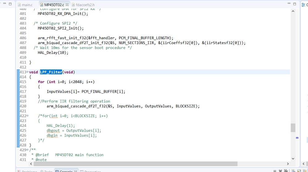

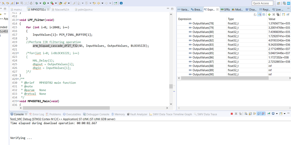

Hi all,
I am developing an IIR filter with CMSIS-DSP but it gives wrong output data mostly (inf) , even that the data is correctly acquired, I test FFT and it's work great!
Any help will be appreciated.
Thanks in advance.

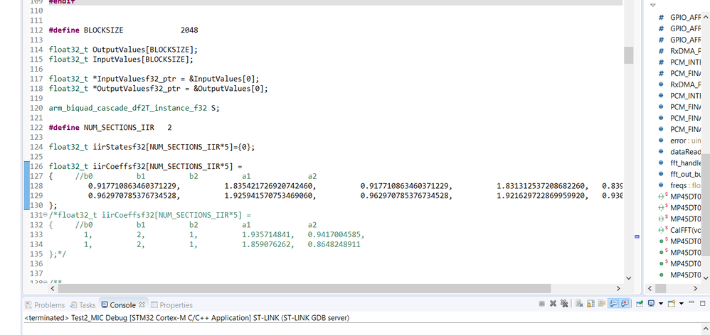

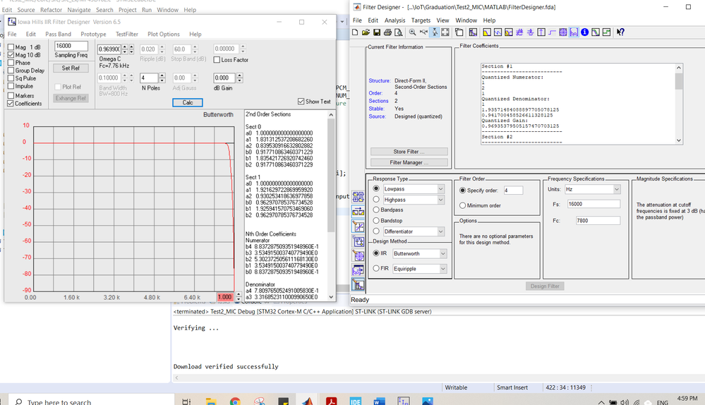

2020-11-17 6:10 AM
HI @Imen DAHMEN
I just flip a1 and a2 coefficients sign, just as simple as that! Actually, it took a lot of my time:grinning_face_with_sweat: hope to save other people time
The same thing in MATLAB and lowa Hills IIR filter designer tool.

2020-11-17 6:10 AM
HI @Imen DAHMEN
