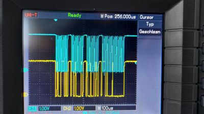

I have an STM32H503RB (NUCLEO-H503RB) trying to read out some I2C slave devices. It actually works only for one of the devices. This tells me, that the I2C bus is somehow working correctly.
But for the remaining three IC (Temperature, GPIO & ADC), there is no way for me to even send the register address.
Right after the Device address, the communication ends. See the attached file. This is the communication to an MCP9801T temperature sensor (device address [W] = 0x92).
I actually don't understand the reason, why this happens.
f=100kHz
What I did:
- changing pull-ups: same behaviour for 4.7kOhm & 3.0 kOhm
- soldering the device on an otherwise empty PCB: only the 100nF, the pull-ups and the MCP9801T is there.
- I2C-Deinit as well as I2C-Init.
The source code is as simple as that:
while (1)
    data[0]=0x00; data[1]=0x01;
    HAL_I2C_Master_Transmit(&hi2c1, Temp_ADDR_W, &data, 2, 10);
    HAL_Delay(1000);
Has anyone at least an idea where to look at? Of course, let me know, what information you are missing.
Thank you very much in advance!
Best regards!

Hello Karl,
thank you for your quick reply. Indeed, i missed to mention that fact: Pin A0 of that chip I connected to 3.3V, A1 & A2 to GND. So in my case it is 0x92.
But what I did, just to check address mistakes: I went through all available addresses:
0x00, 0x02, 0x04,..., 0xFC, 0xFE
to see, if any of these addresses would allo to also send the register address byte. But no address did. Except for the working IC.
To give the full picture, what I have on this PCB:
- MCP9801T, Temperature (write address 0x92): failure in transmission
- PCA9554PW, 8ch GPIO (write address 0x4E): failure in transmission
- MCP3427, 2ch ADC (write address 0xD0): failure in transmission
- KTD2052, 4ch RGB-LED driver (write address E8): successful transmission
I have two PCBs with the full set of ICs. Because on both boards the behaviour is the same, I doubt, that I destroyed all 6 ICs with the soldering. I think it sth systematic - which, of course, I don't understand.
Here is the picture of addressing all 4 ICs one after each other:
while (1){
    data[0]=0x00;// data[1]=0x01;
    HAL_I2C_Master_Transmit(&hi2c1, GPIO_ADDR_W, &data[0], 1, 10);
    HAL_I2C_Master_Transmit(&hi2c1, ADC_ADDR_W, &data[0], 1, 10);
    HAL_I2C_Master_Transmit(&hi2c1, Temp_ADDR_W, &data[0], 1, 10);
    HAL_I2C_Master_Transmit(&hi2c1, LED_DRV_ADDR_W, &data[0], 1, 10);
    HAL_Delay(1000);

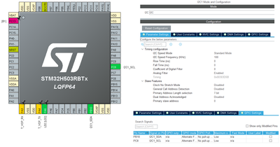

This is my I2C configuration:
Thanks again for your help!

Hello Karl,
sorry for the confusion. When I was talking about the addresses I took the device address and attached the write-bit already. Meaning:
- MCP9801T, Temperature (dev-addr:0x49; full write address 0x92): failure in transmission
- PCA9554PW, 8ch GPIO (dev-addr:0x27; full write address 0x4E): failure in transmission
- MCP3427, 2ch ADC (dev-addr: 0x68; full write address 0xD0): failure in transmission
- KTD2052, 4ch RGB-LED driver (dev-addr: 0x74; full write address E8): successful transmission
So when I was talking about all the addresses, that I was checking, i meant the device addresses 0x00 ... 0x7F plus the write bit=0. I know about the reserved broadcasting addresses, though I wanted to have them tested just for the complete picture.
I have changed HAL_I2C_Master_Transmit now to Mem_write:
uint8_t reg_addr = 0x00;
uint8_t data16[] = {0,0};
while (1){
    HAL_I2C_Mem_Write(&hi2c1,Temp_ADDR_W, &reg_addr,I2C_MEMADD_SIZE_8BIT, data16,2,10);
    HAL_Delay(1000);
 The result remains disappointing:
What I tried additionally:
- changing to 400kHz: no improvement
- changing to 50kHz: no improvement
- adding an I2C sensor that I successfully used in the past with another microcontroller which has Pull-ups of 1kOhm soldered next to it. This sensor cannot be addressed as well. Same picture on the oscilloscope.
- with these 1kOhm-Pull-ups I tried to access the 4 other Slaves: picture unchanged: GPIO, ADC & Temp failed, LED-DRV still possible to send the address byte.
Best regards
