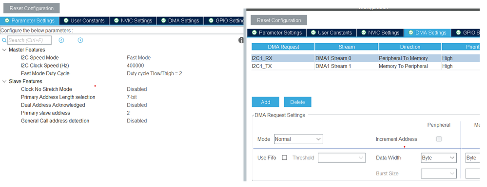

I have developed a code in FreeRTOS mode that contains two main tasks. The first one check if I have received an RX buffer on the I2C bus, and the second one manage the data that has been received.
However, after receiving the first buffer, I am getting HAL_I2C_STATE_BUSY_RX, and I cannot transmit a response to the master device but I'm able to receive another RX buffer . Can anyone please help me?
I'm using I2C in DMA normal mode.

In this case, what should I do to check if I have received an I2C bus message from the master? I am currently using the method in the code below, but I am getting the I2C state as "HAL_I2C_BUSY_RX." Despite that I'm able to receive data from the master, I am unable to transmit any data.
if(HAL_I2C_GetState(&hi2c1) == HAL_I2C_STATE_READY)
		  ret = HAL_I2C_Slave_Receive_DMA(&hi2c1, (uint8_t*)&RX_I2C_Buffer, sizeof(RX_I2C_Buffer));

I'm able to transmit data from the master device and receive it on the slave device successfully. However, I'm encountering difficulties when trying to perform the reverse operation, which is transmitting from the slave device and receiving on the master device.
