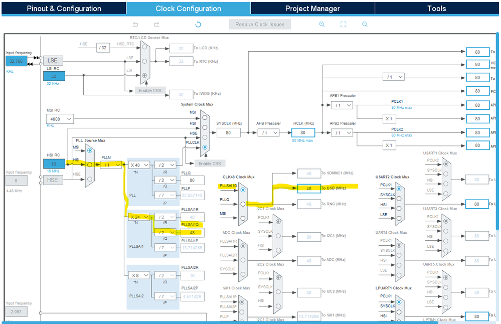

I have a USB problem with "nucleo_l476rg" in version RTOS V3.3.0 where my overlay works fine with RTOS V2.7.4 Overlay has been Migrated to the new way used in V3.3.0.
Tt.1
Error Message:
 Booting Zephyr OS build zephyr-v3.3.0
[00:00:00.000,000] <err> usb_dc_stm32: USB Clock is not 48MHz (4000000)
[00:00:00.000,000] <err> cdc_acm_composite: Failed to enable USB
I manage to get "nucleo_l496zg" running, when I found the enable for "clk_hsi48"
The "nucleo_l476rg" don't support "" and do not have a dedicated clock for USB
Not sure how to setup the STM internal clock to in the zephyr way?
It looks like there is missing some of the settings that showed in STM32CubeIDE.
Created a project with a usb serial just to get the autogenerated setting for zephyr.
Is there a "bug" in V3.3.0 when the STM don't support the clk_hsi48?

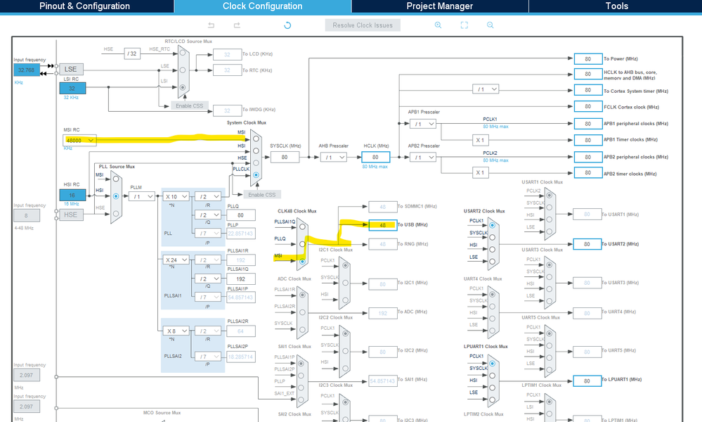

Tt.1
I got it solved at the end with help from a coworker
Those switches is not easy to set right with device tree ..
If any one also can use it
Adding this changes
&clk_lsi {
    status = "okay";
&clk_lse {
    status = "okay";
&clk_hsi {
    status = "okay";
&pll {
    div-m = <1>;
    mul-n = <10>;
    div-r = <2>;
    clocks = <&clk_hsi>;
    status = "okay";
&rcc {
    clocks = <&pll>;
    clock-frequency = <DT_FREQ_M(80)>;
    ahb-prescaler = <1>;
    apb1-prescaler = <1>;
    apb2-prescaler = <1>;
&clk_msi {
    status = "okay";
    msi-pll-mode;
    msi-range = <11>; /* to get 48MHz */
