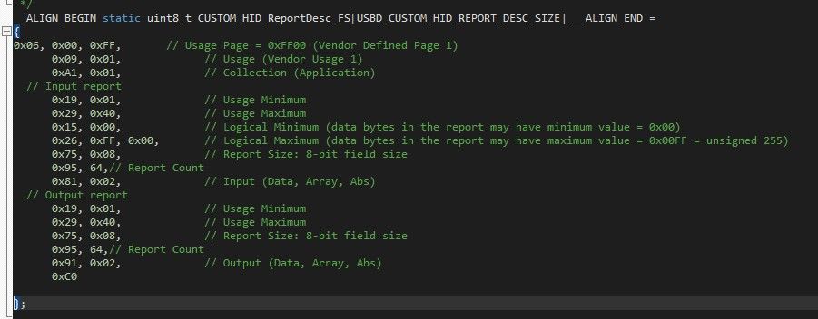

I can easily see in debug what I send from terminal but I cant send any data from stm32f4 discovery.I think I didnt make report descriptor work to sending data.This is what I have done so far:
I try to send data with data array in while but not working:
while (1)
/* USER CODE END WHILE */
/* USER CODE BEGIN 3 */
      dataToSend[0]=0x00;
      dataToSend[1]=0x00;
      dataToSend[2]=0x00;
      USBD_CUSTOM_HID_SendReport(&hUsbDeviceFS,dataToSend,3);
I simply want to send random 64 Bayt Array.
