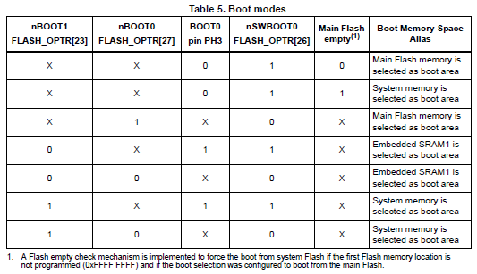

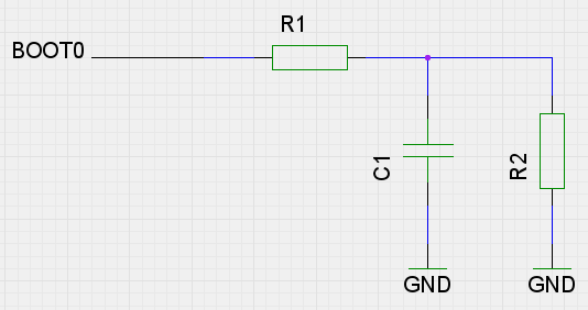

I am trying to jump from my application into the bootloader. It works as long as I pull the pin BOOT0 high, which in my case means setting a jumper. Is there a way to get into the bootloader while BOOT0 is pulled low? My device is STM32L412.

I also tried configuring BOOT0 pin as ouput and setting it high before Jump_To_Boot() but without success.

The hardware method
Add some external components to the pin so it can hold its state for a couple of microseconds.
The software method
Boot pins can be overridden by the nSWBOOT0, nBOOT0, nBOOT1 user option bits
but then you'll have to change them back through the DFU or serial bootloader interface to be able to boot from main flash again.

(I will implement the hardware method on the next board revision.)
