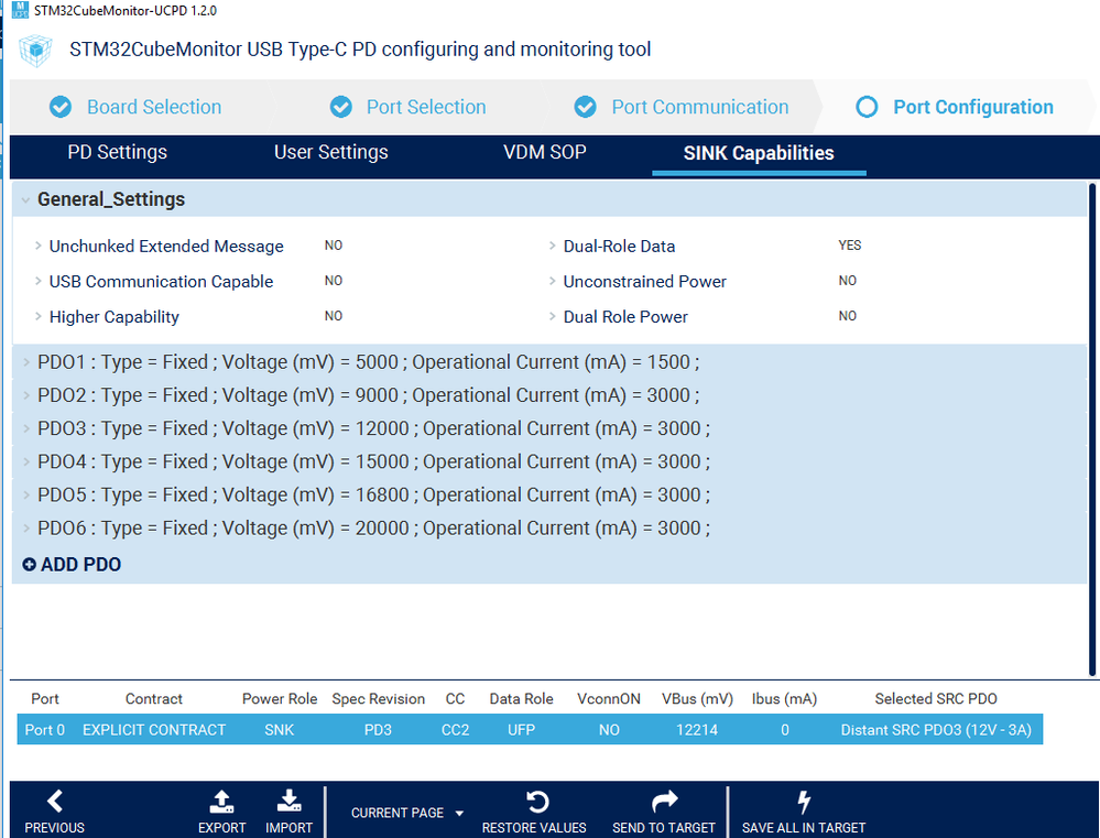

I am working on the STM32G0B1RE processor as a USB-PD SINK.
I would like to ask what is the easiest and fastest method (preferably using CubeMX) to request higher voltages from the USB-PD port (for example 9V or 12V)? Can anyone share the simplest code to request a different voltage from USB-PD than 5V?
Thank you and best regards.

‎2022-01-11 3:20 AM
Hello @Jakub Pepliński​
Please see this wiki for your request: https://wiki.st.com/stm32mcu/wiki/STM32StepByStep:STM32_Advance_USB-Power_Delivery_Sink
It explains how to create a simple PD sink, using CubeMX.
To select 9V or 12V, you will need to follow the complete wiki, including the advanced section.
Best regards

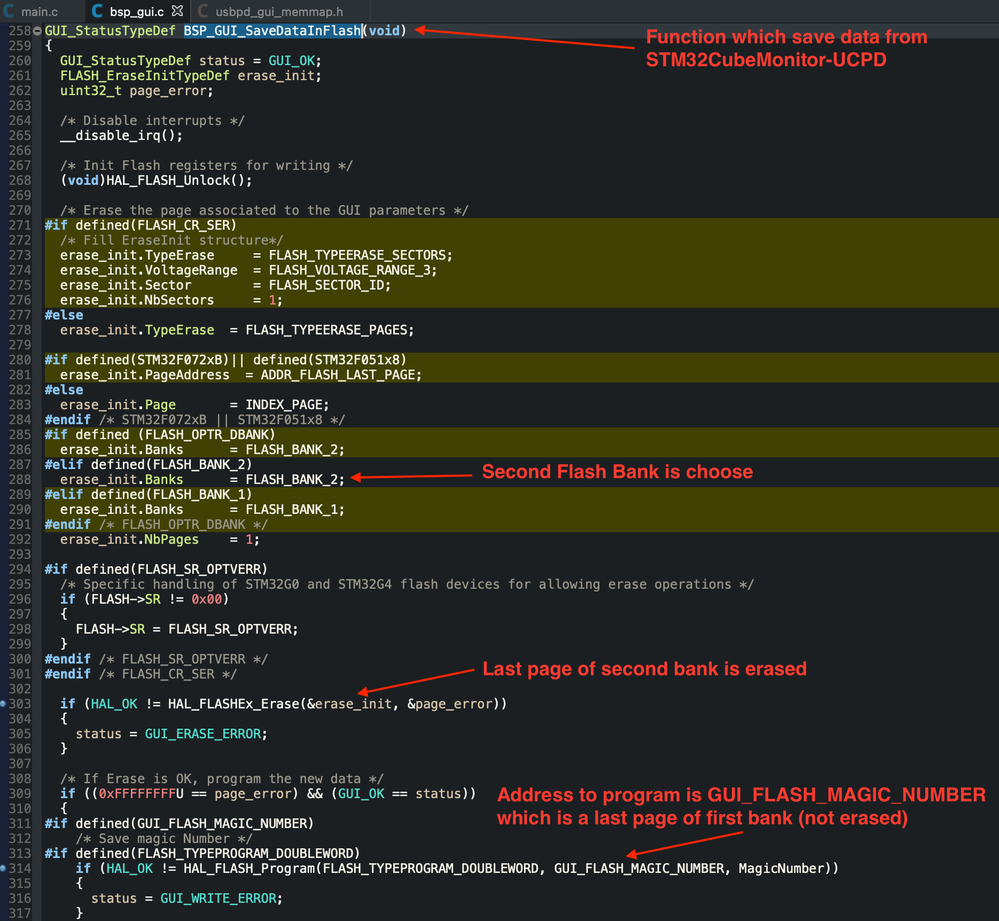

‎2022-01-20 3:03 AM
Hello @HFISTM​
Thank You for your help. I took Your advice and used information from this wiki.
Almost everything is working with only one little issue :) I think that this is a BUG in HAL Library.
As I said - I am using NUCLEO-G0B1RE (not NUCLEO-G071RB like in this tutorial on wiki). The difference is that STM32G0B1RE has dual bank flash memory.
Now - when You try to use STM32CubeMonitor-UCPD and save some information in Flash using "Save all in target" there is a problem and this is not working
In file bsp_gui.c, in function 'BSP_GUI_SaveDataInFlash(void)' - https://github.com/STMicroelectronics/STM32CubeG0/blob/03cb8e9ec0cbefad623caebe47359df0bab1d05e/Utilities/GUI_INTERFACE/bsp_gui.c#L258
First there is set :
erase_init.Banks = FLASH_BANK_2;
Then Flash page is erased:
if (HAL_OK != HAL_FLASHEx_Erase(&erase_init, &page_error))
status = GUI_ERASE_ERROR;
The page which is erased is last page of second bank.
And then Flash memory should be write:
if (HAL_OK != HAL_FLASH_Program(FLASH_TYPEPROGRAM_DOUBLEWORD, GUI_FLASH_MAGIC_NUMBER, MagicNumber))
status = GUI_WRITE_ERROR;
but address to be write is GUI_FLASH_MAGIC_NUMBER which is last page of first bank (and this page is not erased).
Look at the picture below. Everything should be clear then:

‎2022-01-25 12:47 AM
Hi @Lmatt.1​ ,
I will try to help You :)
First of all - this issue which I described before - it's only affects processors with double flash memory banks (like STM32G0B1RE - with flash size >128kB). Please look at "RM0444 Rev 5" document, page 68 - "FLASH main features". What is the uC You are working on?
Secondly - this problem is only relevant if You would like to save parameters in "Port Configuration" tab in STM32CubeMonitor-UCPD application.

‎2022-01-25 1:32 AM
Hello @Jakub Pepliński​ and thank you for your analysis.
You are indeed right, this issue will be updated on our side.
Meanwhile, to fix it, you can try to add this line:
#if defined (FLASH_OPTR_DBANK) || defined(FLASH_DBANK_SUPPORT)
instead of:
in file usbpd_gui_memmap.h, line 51.
This is due to a different flash flag name between G0 series, and it should be updated in the template accordingly.
Can you confirms that it works for you with this fix ?
Thank you,
Regards
‎2022-01-25 1:39 AM
Hi @HFISTM​ ,
Yes, this solution work perfectly fine.
I also figured it out a few days ago and tested it and it works great.
