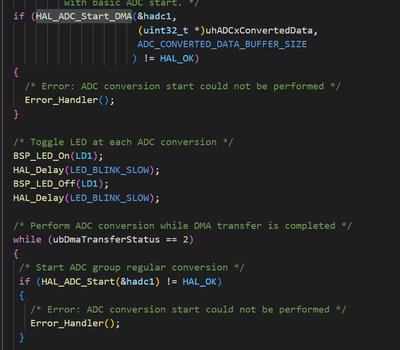

I tried to set up and use HPDMA with ADC on my Nucleo-H7S3L8,
but I have some questions about how to use it.
- I could not find documentation on using HPDMA with STM32 MCU, only for GPDMA.
- I found an HPDMA example for the Nucleo-H7S3L8 (ADC_SingleConversion_TriggerSW_HPDMA), but I don't get the logic. Why are both HAL_ADC_Start_DMA() and HAL_ADC_Start() used together? Normally, you'd just use HAL_ADC_Start_DMA(), right?
- Continuing from my previous question, if I want to modify this example to support multiple channels, Continuous Conversion Mode, and DMA circular mode, how should I do it?
I tried modifying the ADC parameters to Continuous Conversion Mode and DMA circular mode, but it still only runs once.
Then I tried enabling Circular Mode in HPDMA, but it gets stuck at HAL_ADC_Start_DMA. - If possible, could you teach me how to modify it for multiple channels? I'm not sure whether to use End of single conversion or End of sequence of conversion. I have 9 channels.
I'm also not sure how to configure it with DMA.
Attached is the ADC_SingleConversion_TriggerSW_HPDMA example.

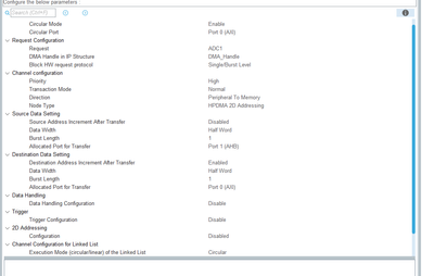

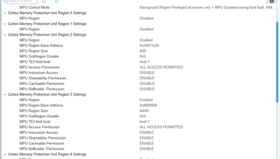

‎2024-08-08 7:16 PM
Hi @CMYL
Your code for regular DMA cannot be used with GPDMA and HPDMA.
I successfully ran Continuous Conversion Mode and DMA Circular Mode after enabling HPDMA and ADC in CubeMX.
Based on my debugging experience, the following points are key (though they might not be entirely correct).
- Enable M7 APPLI MPU
- Enable HPDMA and configure
- Link data to HPDMA channel node and enable HPDMA clock(By the way, I don't know why CubeMX didn't enable the HPDMA clock for me. Is this a bug?)
My method is not a very good one; I found your GPDMA tutorial.
https://rristm.github.io/tomas_materials_v2/RRISTM/stm32u5_workshop/master
I followed the link-list setup in the tutorial, but it didn't work.One important reason is that the U5 only has one project, while the H7S3 has two: BOOT and APPLI.Maybe you should release an HPDMA tutorial for the H7S3.

‎2024-08-09 2:55 AM
Hello @prometheans152
Sorry, I didn't pay attention that GPDMA/HPDMA is used. The H7S/R series has only GPDMA versus DMA in H7xx series.
Let me notice the difference in circular mode programming between GPDMA/HPDMA (General Purpose DMA) and DMA (Direct Memory Access).
- GPDMA: When using GPDMA in circular mode, it is essentially linked-list with one node configuration. This means that even if you select "Standard Request mode," the configuration will still involve linked-list.
- DMA: Traditional DMA does not inherently require linked-list configuration for circular mode. It can operate in circular mode without the need for linked-list setup (as linked list is not supported).
Thanks for giving the solution :)
Sorry I missed a last comment in my last message above: " I'm working on a project for Continuous Conversion Mode and DMA Circular Mode based on HPDMA, I will share it with you".
Note that for H7S series you need to focus on Appli project and use the boot project as provided by CubeMx for the Nucleo-H7S. Otherwise, I will share with you also the Howto for running and debugging your usecase.

‎2024-08-15 2:25 PM - edited ‎2024-08-15 2:26 PM
I deeply reviewed your questions. Here the answers to questions 1 and 2.
(I keep the answers to 3 and 4 in the next prompt window.)
- I could not find documentation on using HPDMA with STM32 MCU, only for GPDMA:Answer: HPDMA is detailed into the RM0477, chap 13.
- Normally, you'd just use HAL_ADC_Start_DMA(), right?
- ==> Answer:Your are right HAL_ADC_Start_DMA() and HAL_ADC_Start() can't be used together unless in your configuration of ADC you choose single conversion.
- Why are both HAL_ADC_Start_DMA() and HAL_ADC_Start() used together in the example ?
- ==> Answer: This is related to the use case choice of ADC and HPDMA configurations as given by the readme file. The ADC peripheral performs a single ADC conversion on a channel at each "software start" as the ADCcontinuous mode is disabled and ADC start conversion is done by SW. In this case the ADC will convert one value then STOPs, then the DMA will not receive any request and remains waiting. That's why we need to restart the ADC by SW after each transfer until we reach the number of HPDMA transfers. The call to HAL_ADC_Start() will not be necessary if continuous conversion mode is enabled.
//hadc1.Init.ContinuousConvMode = DISABLE; // --> ENABLE
hadc1.Init.ContinuousConvMode = ENABLE;
hadc1.Init.ExternalTrigConv = ADC_SOFTWARE_START;
Thanks
‎2024-08-15 4:41 PM
For the following questions 3 and 4 below:
- Question 3: Continuing from my previous question, if I want to modify this example to support multiple channels, Continuous Conversion Mode, and DMA circular mode, how should I do it?
Then I tried enabling Circular Mode in HPDMA, but it gets stuck at HAL_ADC_Start_DMA. - Question 4: If possible, could you teach me how to modify it for multiple channels? I'm not sure whether to use End of single conversion or End of sequence of conversion. I have 9 channels.
Answers:
- Please find my Step -by-Step demo in the attached document ADC_DMA_circular_usingSTM32CubeMx.pdf
- For the setting of STM32CubeIDE to avoid loading the boot binary each time you want to debug see attached document H7S_CubeIDE_config_Howto - Copy.pdf
- The whole project is attached ADC1_HPDMA_CircularMode.zip
