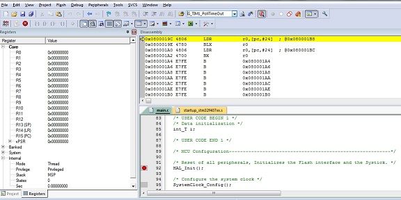

Hi, clivel, I just did some test. If I keep default address settings, the debugging works normal. However, when I change IROM1 to 0x80E000 and size to 0x20000 (128K), the debugging failed to jump to main entry. I captured the screen and you can see almost all debugging buttons are greyed out. Any idea why and how to solve it?
LR_IROM1 0x080E0000 0x00020000  {    ; load region size_region
  ER_IROM1 0x080E0000 0x00020000  {  ; load address = execution address
   *.o (RESET, +First)
   *(InRoot$$Sections)
   .ANY (+RO)
  RW_IRAM1 0x20000000 0x00020000  {  ; RW data
   .ANY (+RW +ZI)

Yes, you'd need code, or vector entries, at the base of the flash to transfer control to new location.
From the debugger perspective you could assign SP and PC to the appropriate values you could get these from the vectors at the base of your image. You code in SystemInit() would also want to set the vector table address (SCB->VTOR) to point to the new base address.
