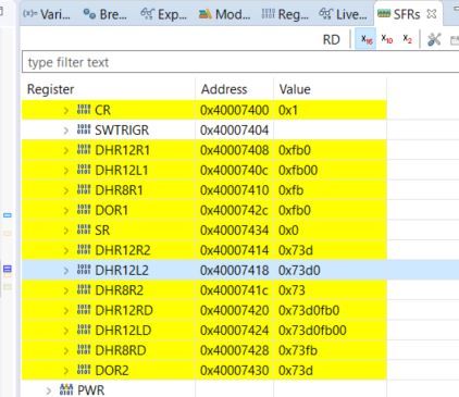

I'm working on a simple, bare metal application where right now I am passing in values read from the two ADCs and then write the same values to the corresponding DACs. I have confirmed by stepping through the code and using a volt meter.

> The value in DAC2 _OUT is garbage.
What do you mean by garbage? Read out and check/post the DAC registers' content, explaining how do they depart from the expectations.
‎2020-08-03 9:03 AM
Hi JW,
By garbage I mean that the voltage read on my voltmeter does not match the value read from the ADC that I pass to it. I'm quite new to this, so please excuse dumb responses to your questions. I did a screen grab.
At the first ADC, the input voltage is 4.95V which is read as a value of 4000 (0xFA0). This is written to the first DAC, and a value of 4.89 V is read back (close enough). On the second ADC, the input voltage is 2.37 V which is read as a value of 1855 (0x73F), but I read 0.68 Volts.
Did I display the contents of the DAC register correctly?
Thanks,
KKoem1
‎2020-08-03 11:21 AM
By "read out and check" I mean, check yourself, against the expected values based on reading the given (DAC) chapter in Reference Manual (RM).
DAC_CR is 0x0001, i.e. you don't have enabled DAC2 (DAC_CR.EN2 = 0).

JW,
Got it and I see the issue where the DAC_CR.EN2 is 0: bit 16 in 14.10.1 in the RM0091 for the STM32f0x2 (and others).
