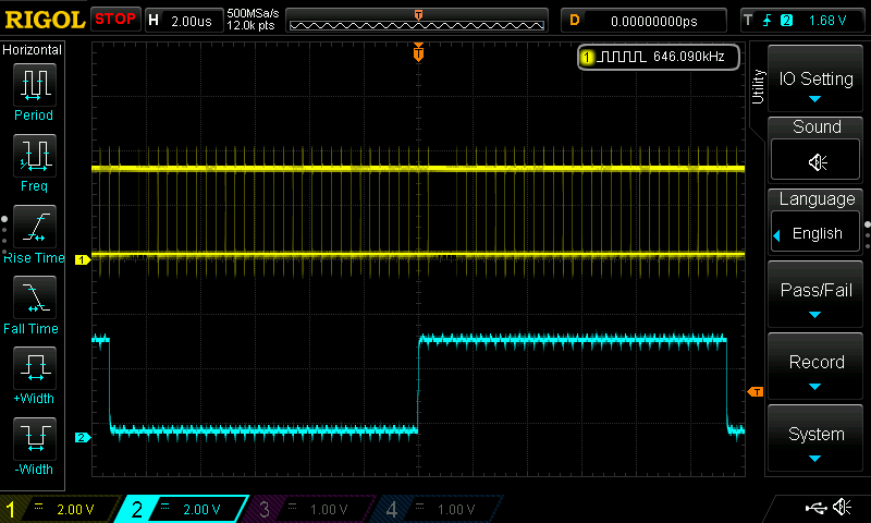

i had I2S 16bit out in slave mode running, but with 32bit data no success. always wrong byte order.
so i try SAI , slave mode, 32bit data. but nothing coming from SAI....check with DSO.
also DMA -> callbacks for half + full buffer never triggered.
i dont know, what i am doing wrong, anyone can help ?

got it working.
what STM could do better:
  1. clear description, what is the size of a "slot" (and what is, when you set it wrong).
  2. change vage description on what DMA is to set: not "amount of data", but "number of transfers"
so you know, blocksize is not in bytes , but in size of transfer element (maybe byte or 16...32 bit)
now correct timing on 32bit data:
--- what was not possible with I2S - although no fault is in errata about i2s not working if data > 16 bit.
