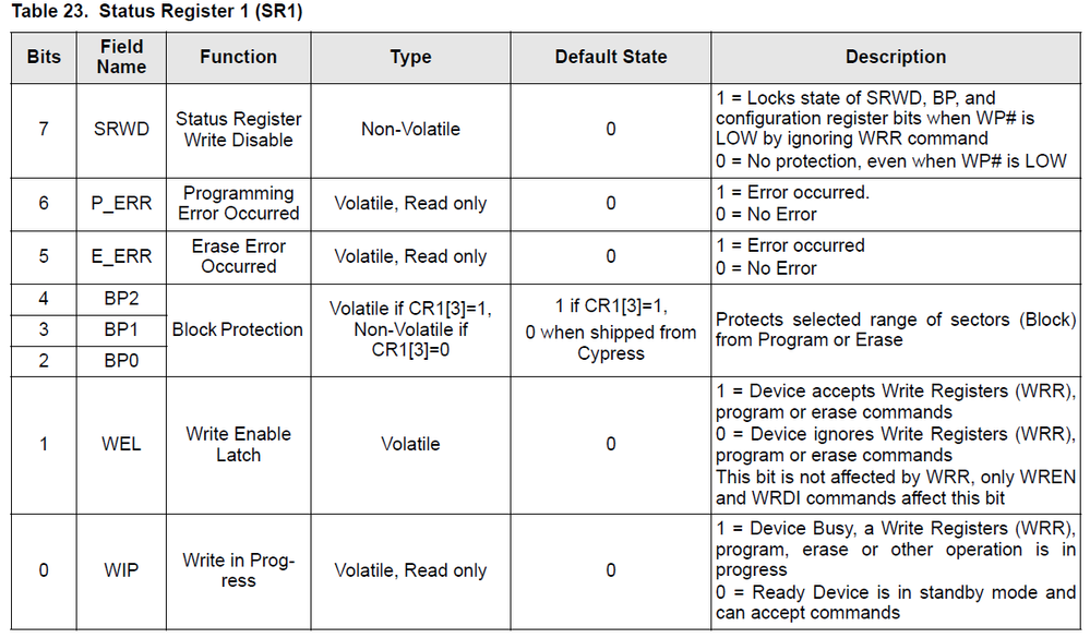

I’m trying to get my STM32H743 to communicate with a Cypress S25FL128S.

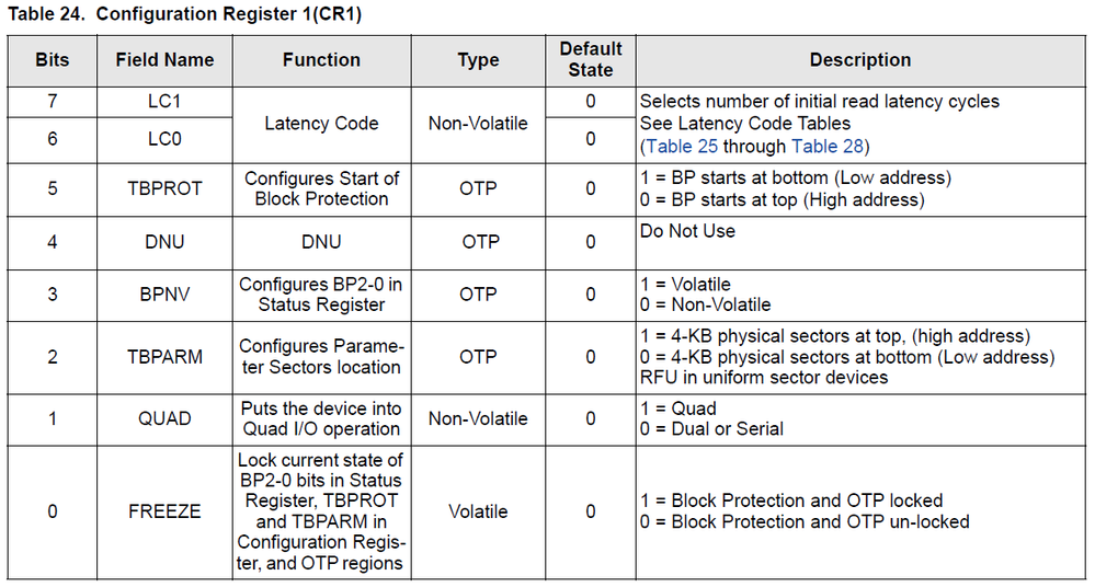

I want to change the state of the Configuration register bit 1 from the default of zero to a one.

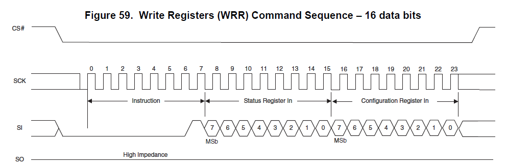

I want to use the HAL_QSPI API to perform this write but I’m confused on how to add two byte command sequence.
Instruction WWR = 0x01
QSPI_CommandTypeDef my_qspiCommand;
 my_qspiCommand.InstructionMode  = QSPI_INSTRUCTION_1_LINE;
 my_qspiCommand.Instruction      = 0x01;
 my_qspiCommand.AddressMode      = QSPI_ADDRESS_NONE;
 my_qspiCommand.AlternateByteMode = QSPI_ALTERNATE_BYTES_NONE;
 my_qspiCommand.DataMode         = QSPI_DATA_1_LINE;
 my_qspiCommand.DummyCycles      = 0;
 my_qspiCommand.DdrMode          = QSPI_DDR_MODE_DISABLE;
 my_qspiCommand.DdrHoldHalfCycle = QSPI_DDR_HHC_ANALOG_DELAY;
 my_qspiCommand.SIOOMode         = QSPI_SIOO_INST_EVERY_CMD;
HAL_QSPI_Command(QSPIHandle, &my_qspiCommand, HAL_QPSI_TIMEOUT_DEFAULT_VALUE);
How do structure this command to add my two byte command sequence?
