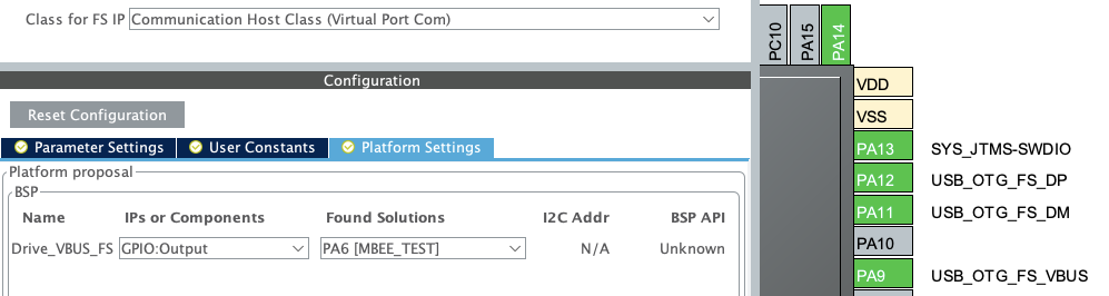

And one more question. Why is this pin in CubeMX?
Already have a USB_OTG_FS_VBUS (PA9) pin, why do I need this Drive_VBUS_FS? What is the function of this?
I don't use CubeMX. Maybe you don't need it. The idea is, that the GPIO is supposed to switch on/off the VBUS power supply, while the VBUS pin serves as sense for the device role, in OTG setting.
