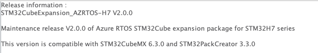

Yes, there is a pack can add to STM32cubeMX for Azrtos.
Here is the update notice I see

After much mucking around I determined trying to use the threadX/Azrtos for STMcubeMX was leading to far too many changes in the code after each "generate", so I mirrored ST's examples. And there use https://github.com/STMicroelectronics/x-cube-azrtos-h7.git as a library.
There appears to be a new revision of https://github.com/STMicroelectronics/x-cube-azrtos-h7.git but that looks like it dropped right after I followed ST's examples using Aezrtos on H7's.
Still tool a fair bit of playing with the CMake to not need to copy all of the contents of threadX and netXduo into subdirectories of the board.
