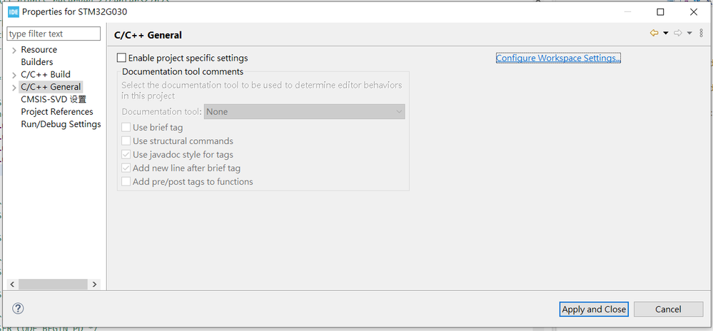

How can I add the STM32G030/Middlewares/Openbootloader/Core/openbl_core.h into STM32G030/Includes?
3 REPLIES 3
KnarfB
Look in Project Properties tab under C/C++ General.
This one?
KnarfB
yes, open it by clicking on the > and you find Paths and Symbols.
There are more alternatives, see STM32CubeIDE user guide (UM2609)
