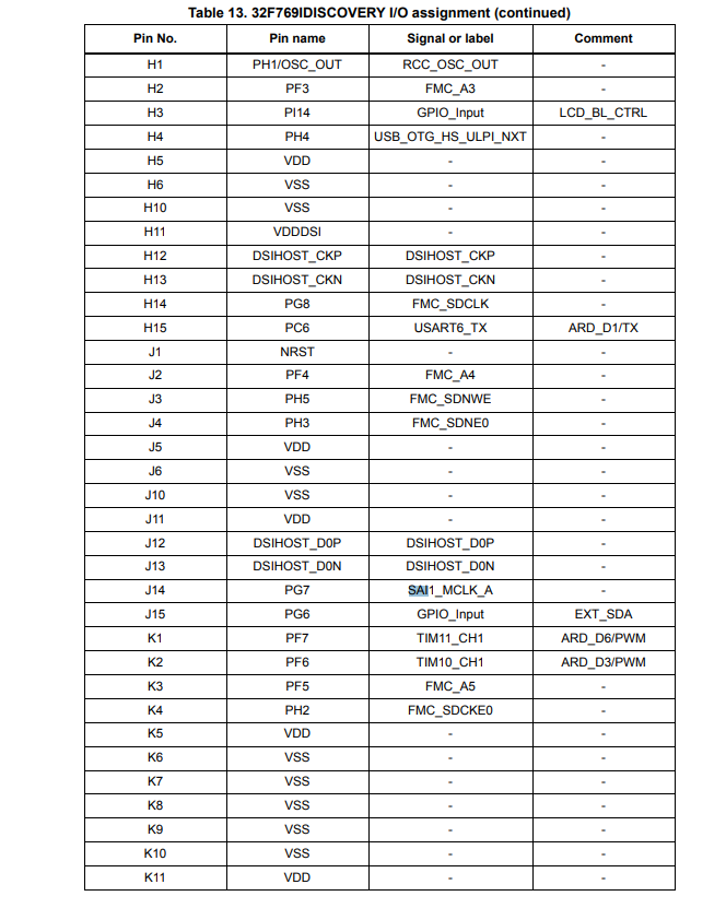

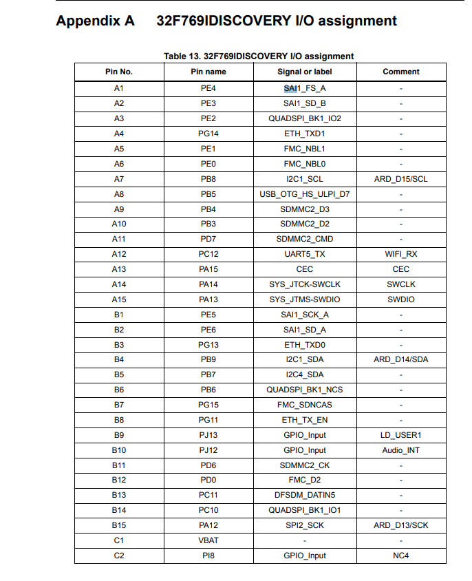

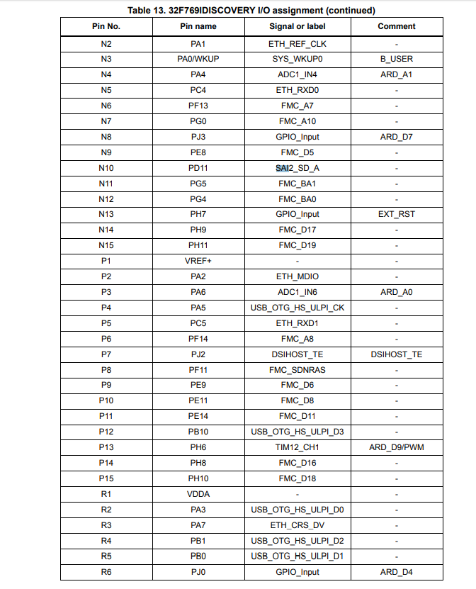

I have an STM32F769 Discovery board. I have used STM32CubeMX to generate the code for an Audio project  How do I access the audio data from SAI2 and the audio data to SAI1 ?

MLawr
I need to know what data items need to used in the C source code. Are they derived from Signal or Label items in the table shown ?
