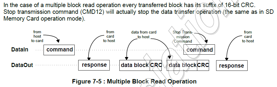

I suppose CMD18 (SD_CMD_READ_MULT_BLOCK) should be sent instead of CMD17 (SD_CMD_READ_SINGLE_BLOCK), and also I have to increase the size of vector ptr to make it big enough to storage n blocks instead of only one. But once that is done, how can I know when these exactly n blocks have been read? At what time should I send CMD12 (SD_CMD_STOP_TRANSMISSION)? Is there some flag or interrupt which can be used?

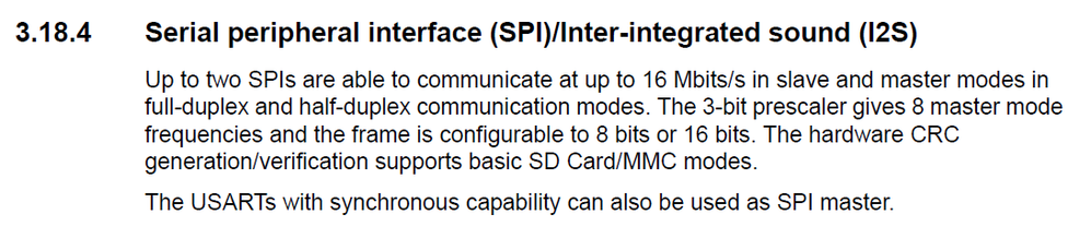

  • Regarding SPI's frequency, STM32L073RZ datasheet (DS10685, Rev 4) indicates the maximum is 16 Mbits/s:
Is there any way to 'push' the SPI frequency limit for this MCU?

Yes, I think so. I use max frequency (32 MHz) of the SPI1's peripheral domain (APB2), and then I use the min prescaler (2). This way, SCLK is 16 MHz, which is the max theoretical value.
I would pay attention to minimize hardware interferences. Thank you for the information.
