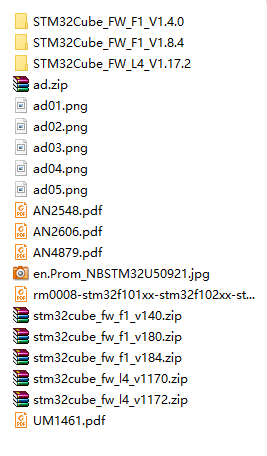

BLu.1
Thanks for your information, but I don't find some samples here:0693W00000UnEJKQA3.png​Thanks
Boone
Go down a few directories
Repository\STM32Cube_FW_F1_V1.8.3\Projects\STM32F103RB-Nucleo\Examples\SPI\SPI_FullDuplex_ComPolling
Repository\STM32Cube_FW_F1_V1.8.3\Projects\STM32F103RB-Nucleo\Applications\USB_Device\HID_Standalone
Suggest you get a better File Manager and search/viewer tools.
