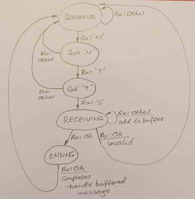

It would be safer to look for the 4E 54 53 sequence (ASCII "NTS"?) to mark the start of the packet, and the 0D 0A (ASCII CRLF) pair to mark the end...

perhaps as a simple State Machine; eg,

Just spotted that I've missed handling "anything other than 0A" in the ENDING state.
As for 0A received in the RECEIVING state, that would indicate a mal-formed message - so should be handled as an error.
PPS:
Of course, using a state machine doesn't fix the (potential?) issue of a 0A or 0D value in the payload being misinterpreted as a terminator - it seems that is a fundamental flaw in the protocol?
(maybe the message is fixed-length, so it would be sufficient just to verify that the final 2 bytes are 0D 0A?)
