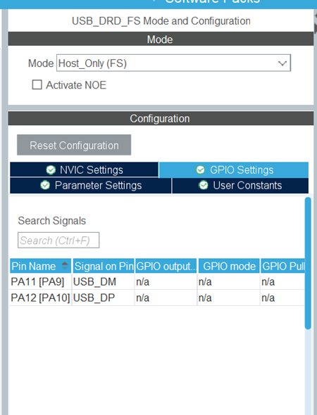

Hello guys, I am working with STM32G0C1RET6. I want to use STM32 as a USB host and want to save data on USB flash stick. I followed some tutorial from ST microcontroller's youtube channel but I am still not able to mount my USB device. what should I do?
‎2022-05-11 8:12 AM
Here are details about my project:
- I have connected my USB_DM and USB_DP pin directly to USB connector.
- I enable A9 and selected as a GPIO output using VBUS setting in CUBEIDE. Which is providing me 3.3V
- I read that there is inbuilt pull up resistor in STM32G0C1RET6. So, I connected USB connector directly to pins
- I used "f_mount" function to mount my usb device.
My USB device is using FAT32 format. I AM SORRY if I made some dumb mistake; I am newbie

‎2022-05-14 11:30 PM
@Community member​ @Javier Muñoz​

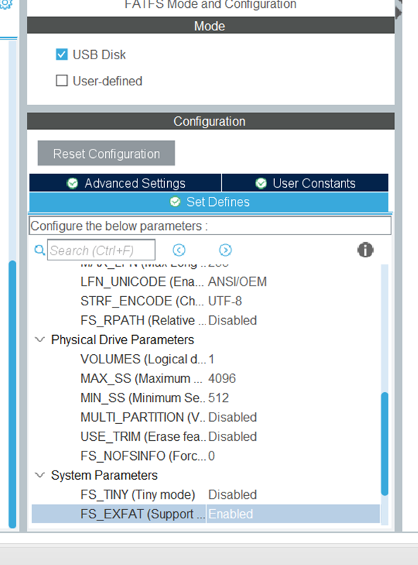

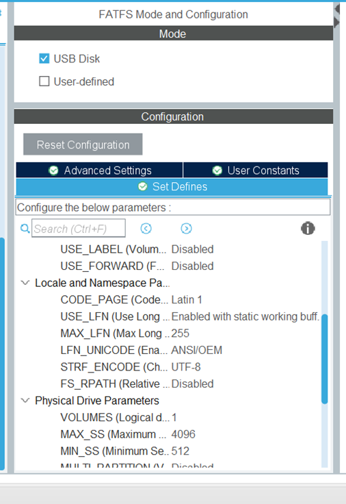

Sorry for bothering you guys again. I have tried to solve DISKIO error but everything is working fine. There are no errors. Can low heap size cause FR_DISK_ERR??
I am posting the code I wrote in "USB_host.c" and my settings which I am using:

‎2022-05-15 5:12 PM
Generally speaking GNU/GCC hides a lot of potential size issues with heap/stack
Some of the USB Driver Stack for devices used the heap.
FATFS can use the heap for things like long filenames, etc, check ff_conf.h
It can also use the stack for auto/local variables, I'd typical look for at least 1 or 2 KB
Suggest the following syntax for the output
uint8_t text[] = "USB not mounted !";
HAL_UART_Transmit(&huart3, text, sizeof(text)-1, 100); // or strlen(text)
‎2022-05-16 8:33 AM
Thank you so much, I have tried everything by fat but I am still not able to mount my USB device, I am using 32GB pendrive; Is that a problem?
I am still getting FR_DISK_ERR. Can you guys post your settings and code?? So I cam identify problem
