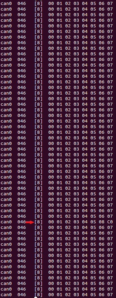

The communication is working fine except randomly the last two bytes are not [0x06,0x07] but [0x08, 0xC0].

I've made a little test program to make it easier to analyzer the false can frame on the bus with a scope. The "false" can frame is actually correct on the bus. So all along it was not the MC's fault but the MCP2515 on the raspberry pi.
After more digging I've found out that the linux version used for the raspberry pi had a different spimaxfrequency default value in the device overlay for the MCP2515. After manually setting the spi max frequency to 10mhz the errors did not occure.
So I assume the spi interface for the MCP2515 was just a little bit too slow and didn't catch the complete buffer befor the next frame came into it?

Edit: it is still occuring but less frequently (every 4-5 minutes). And instead of 0x08 0xC0 on the 7th and 8th byte it is just 0x00 0x00.
