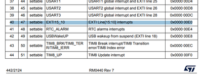

Is it possible to disable a specific GPIO interrupt in my code and re-enable it after some time. HAL_NVIC_DisableIRQ(EXTI4_15_IRQn) this function will help but this will disable all the GPIO pins connected to that particular EXTI line. Any other possible ways I can implement?

In most STM32 the individual EXTI interrupts are enabled/disabled in the EXTI_IMR register, see EXTI chapter in Reference Manual (RM).

Should I need to make changes in the EXTI_IMR register. Or are there any HAL functions I can use to Implement this. Currently I could be able to disable EXTI15_10_IRQn which disables all the GPIOs connected to this line.

According to the reference manual, EXTI line dedicated to 10->15 are regrouped in one vector in NVIC controller. So, using CMSIS, this should not be possible. Maybe, we can implement this operation in HAL driver using directly EXTI_IMR. I will forward the request to dedicated team.

You can use LL_EXTI_EnableIT_0_31() and LL_EXTI_DisableIT_0_31()

Thanks for the solution. When calling for example:
LL_EXTI_EnableIT_0_31(uint32_t EXTI_Line);
how do the individual "EXTI_Line"s map to specific GPIO ports and pins? I see "lines" referenced in the reference manual, but I don't understand the mapping.
EDIT: I may have found the mapping on page 271. It seems that, for example:
LL_EXTI_Disable_IT_0_31(LL_EXTI_LINE_3);
will disable the interrupts on pin 3 of ALL ports. Is that right?

These are two different things.
First comes the multiplexer controlled by SYSCFG register, which selects, which port's pin is used for that particular EXTIn, n = 0..15.
Then output of that multiplexer enters EXTI module and you can then there enable/disable individual EXTI in the EXTI_IMR register, see EXTI chapter in Reference Manual (RM). That's what those LL functions/macros do.
