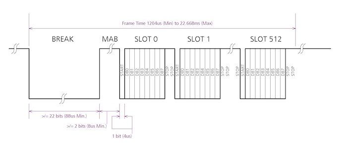

Hi everyone, im trying to send datas to 8 uarts+usarts on stm32f7 mcu. I'm getting datas from ethernet wtih netconn connection. I'm using FreeRTOS and lwIP stack. I have a task that calls netconn_recv(conn, &buf); in infinite loop. When netcon_recv function returns OK i parse datas. Than i send datas to proper ports by interrupt method. But when more than 1 uart data appear at ethernet, my FPS of uart output starts to decrease. I need an advice to increase the speed of data send system.

Ok, so you need to remove the waiting/blocking from your code. Queue the interactions you want to occur, in the order you want them to occur and periodically pump or cultivate the specific channel to see if it is ready to move on to the stage.
Where you have 8 possible channels, have 8 queue that can manage any disparity in rates, and chain the transfers in the callback, or via flags you trigger in the callbacks.
Posted on June 28, 2018 at 15:56
ismail fatih iltar wrote:
2)i need ~100us low pulse at uart. so i send zero at SET1 baudrate than i change it to SET2 normal comm. baudrate.
I'd really like to understand this better, please.  Can you explain this mechanism in more detail?
Posted on June 28, 2018 at 16:02
purpose of low pulse is break condition before data. i must handle the tx line app. 100us at low so if i right, i have 2 ways. first one is setting pin tx to gpio and set it to low after that init like a uart again. second one ise changing baudrate dynamically. So i change baudrate to SET1 and send 0x00 to uart to simulate low pulse after that i change baudrate to SET2 to send my datas.
Posted on June 28, 2018 at 16:31
Thanks for the explanation.  That's what I thought - I definitely would have just flipped the pin into/out of GPIO mode (with the 0 set in the ODR bit at initialization).  Much quicker, much simpler.
