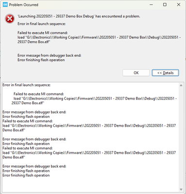

I have been using a NUCLEO-F413 board to try and understand how to program to user FLASH using the example code in the STMicro repository and STM32Cube to program. However when I now try and program the board I get the below error:
Has me trying to write to the FLASH damaged the program space? If so is it possible to restore it or is the board now dead?

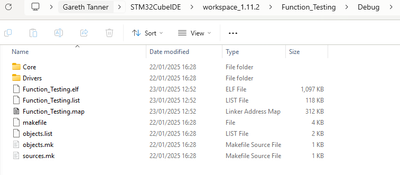

It could be just that the ELF file does not exist ...
‎2025-01-23 4:54 AM
The ELF file does exist.
‎2025-01-23 5:25 AM

‎2025-01-27 6:35 AM
I recommend using STM32CubeProgrammer tool to check the state of your board. Try to connect your board using this tool. If the connection is successful, it indicates that the board is functioning correctly. If the connection fails, please send me a snapshot of the error message for further analysis.
‎2025-01-27 6:40 AM
Using the Programmer has worked, and I am now able to use STMCube to interface with the board. Thank you
