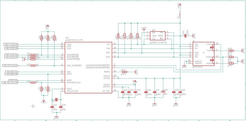

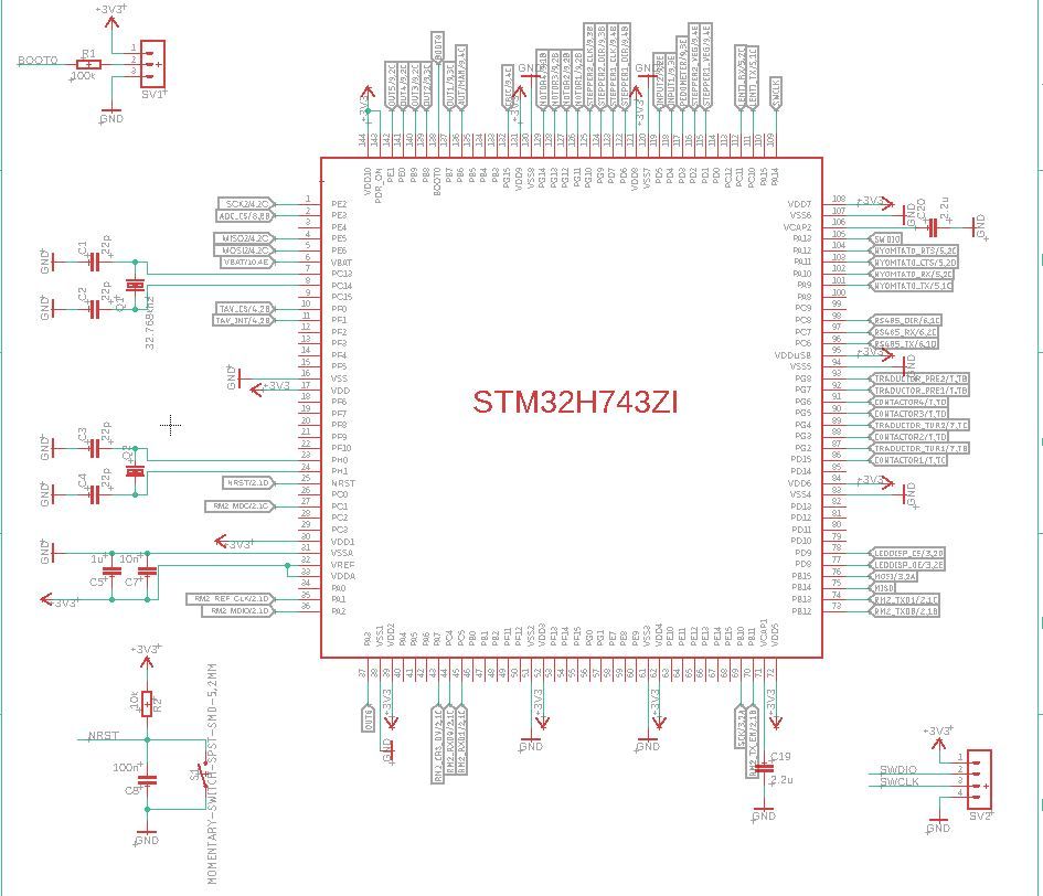

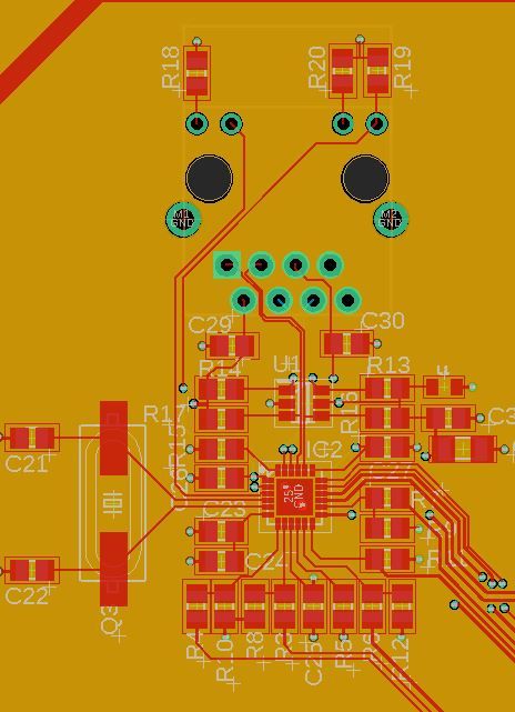

I attach the message I get. I uploaded the bin file with st-link utility. And it doesnt want to get an ip address. I attach my hardware design. Please check if it is correct, the magjack is on the back.

I have tested the board with my oscilloscope. I dont see activity on the transmit pins of the arm. The orange led blinks when I connect an ethernet cable, the yellow led light is on permanently. The ETH PHY chip reacts to the NRST, leds are turning off. I get an 50MHz signal on the ref_clk_out pin going to the arm.
Best regards,
Attila
