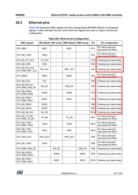

The pins ETH_MDC, ETH_TXD2, ETH_TX_CLK, ETH_CRS, ETH_RX_CLK, ETH_MDIO, ETH_COL, ETH_TX_EN, ETH_TXD0, ETH_TXD1, ETH_TXD3, ETH_RX_DV, ETH_RXD0, ETH_RXD1, ETH_RXD2 & ETH_RXD3 pin's modes are set to GPIO_MODE_AF_PP.

The table above says you should set those pins to Input, not AF.
The 'F1 has a rather strange GPIO arrangement. RM0008 says:
If the mode is set to GPIO_MODE_AF_PP, the HAL does not control the input pull state.
The HAL_ETH_MspInit function does sometimes set
GPIO_InitStruct.Pull = GPIO_NOPULL
but HAL_GPIO_Init does not bother checking GPIO_InitStruct.Pull if mode = GPIO_MODE_AF_PP.
waclawek.jan
