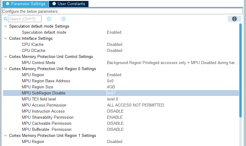

We have an STM32H735VGH6 on a custom board with a LAN8742a PHY chip to allow ethernet communication. This custom board is minimally tested so it's possible that there's a hardware issue though I'm uncertain where the issue would be. I generated the MCU project using STM32CubeMX (ver 6.12.0) and have been running it with STM32CubeIDE (version 1.16.0). In all versions that I'm running, the MPU is setting all 4GB of space to be non-cacheable.

Hi. Your MPU configuration doesn't set all 4GB of space to be non-cacheable.
This overwrites the default settings to prevent speculative read to unavailable memories (range 0x60000000 to 0xE0000000, set as strong ordered, code execution disabled). See tutorials: https://community.st.com/t5/stm32-mcus/how-to-create-a-project-for-stm32h7-with-ethernet-and-lwip-stack/ta-p/49308 or on youtube
