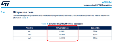

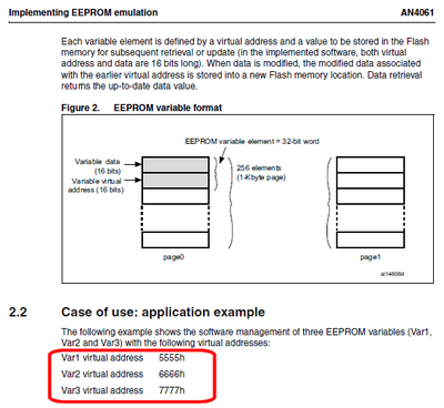

Both X-CUBE-EEPROM and STSW-STM32117 (AN4061 - for STM32F0) use "Virtual Addresses" in the emulated storage:
But nowhere explains how these "Virtual Address" numbers are determined/decided.
It seems to me that (apart from 0x0000 and 0xFFFF being reserved)*, the choice is completely arbitrary - is that right?
The examples use "sparse" virtual address values - is there any advantage in doing that ?
Would there be any benefit in choosing values with maximum spacing - more "entropy" ?

‎2024-06-11 2:34 AM
Hi @Andrew Neil ,
Yes these 3 values are arbitrary chosen. You can give them the value you want (in the X-Cube example the value are 1/2/3, etc.).
The thing is that you can give the value you want, it can be useful if you want to give a value that means something in your application, but right there, that's totally arbitrary.
I hope this helps,
