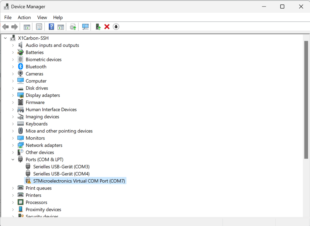

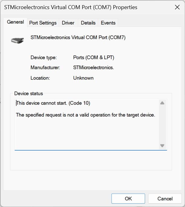

I keep getting an error message when installing the latest STM32 virtual com port driver on both Windows 10 and Windows 11 - can anybody suggest a solution?

Hello @SSchu.12​ ,
Try increase the heap and the stack size or configure the USB library to use static allocation.
I invite you to follow this FAQ related to the problem "USB device not recognized":
Hope this helps you.
If my answer satisfy your need, please select it as Best so that this thread will marked as solved.
Imen
Thanks
Imen
MwF2DD
same problem are there adapter drivers?
