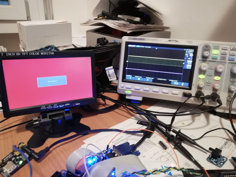

I am developing a custom board that mounts a STM32F469 MCU. The board is very simple, and the circuit embeds only the main 8Mhz crystal and the RTC 32.768 one. No embedded peripherals except for a couple of status LEDs and a MUX 74*138 chip used to select memory banks on an expansion BUS based on the FMC.

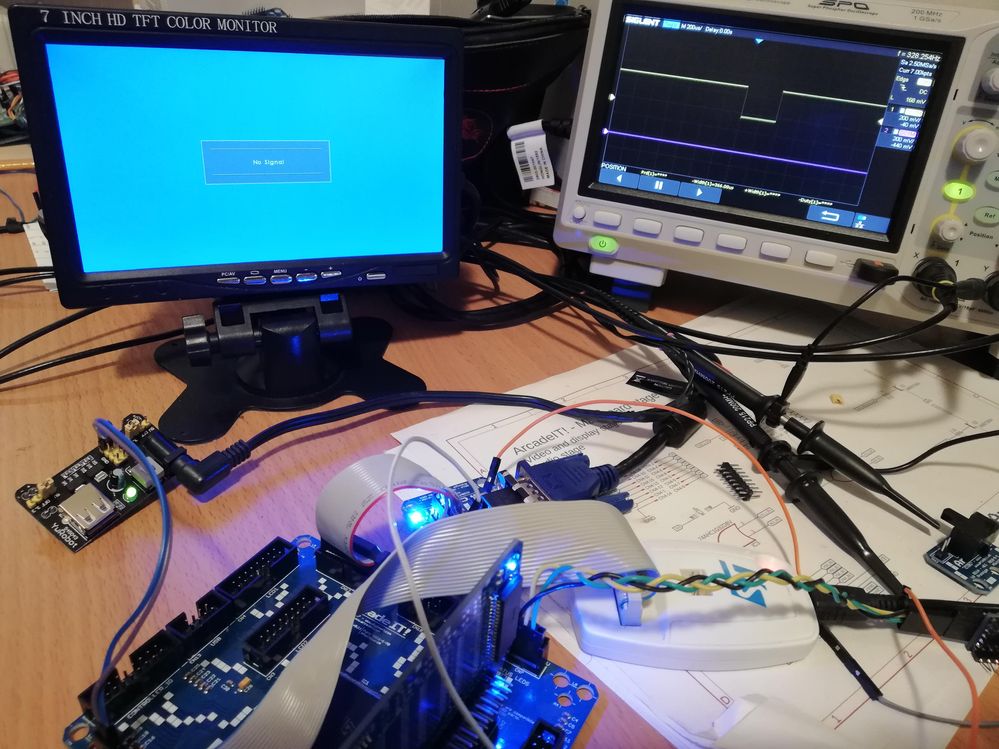

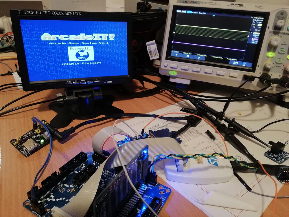

The weird problem that I am experiencing is that when I power on the board, the clock seems to run slower than it is supposed to run. The scan line, which is generated by theTIM8 that trigs the DMA, seems to take more time. BUT, if I push the reset button (this is a simple reset circuit with a pull-up resistor) the speed increases. Sometimes after the first reset it fixes and goes to the correct one, sometimes it needs more resets to adjust.

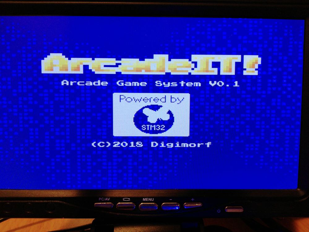

As you can see from pics, the monitor doesn't catch the signal until the third reset. Really weird.
If the clock wasn't properly configured the TIM8 shouldn't generate the signal at all, on the other hand, the circuit should be correct, otherwise, the clock shouldn't work correctly. It seems that the reset is needed to stabilize the clock.

After several tests, I decided to start with a new and fresh project. So I rebuilt everything and now the clock is perfect as expected. I believe that something went wrong when I imported the project after a big update. I have tested it again, and I had no problems.

can you try to increase the default software timeout of all HSE , LSE clocks before the Ready bit is set. Same for PLL lock as well. You should find it in the Clock setup functions. It may happen that with your selected crystal start-up it is a bit longer after power Up. When doing a soft reset the clocks may be stabilized and ready after the expired timeout.
