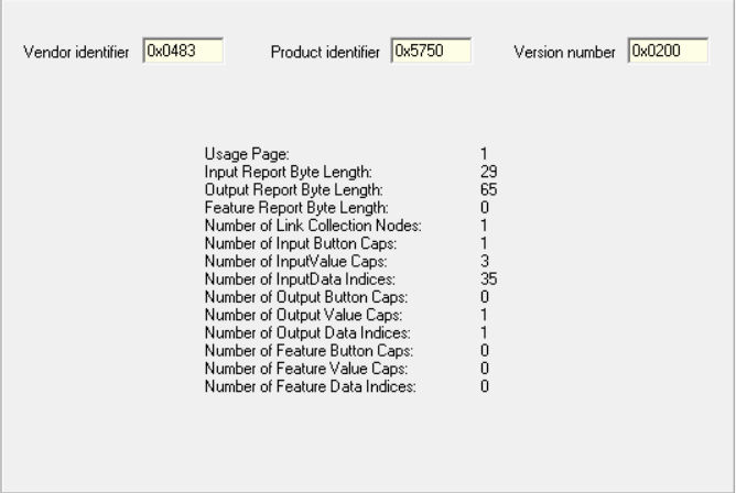

I have a stm32f411 with custom hid running smoothly. But if i change a value in the report descriptor data transmission stops working.
I want to change the descriptor cause i want to send more data to the host.
Here is the descriptor which works

Using the USB demo tool tells me the input report byte length is 29
0693W00000Dq1vxQAB.pngNow i want to crank this to the maximum which according to my knowledge is 64 bytes.
If i change the report count in the following line to 35 that should make a input report byte length of 64 in total.

Unfortunately a report count of 35 hangs the data transmission.
I sure can need some advice on what i am doing wrong or where it goes wrong.
