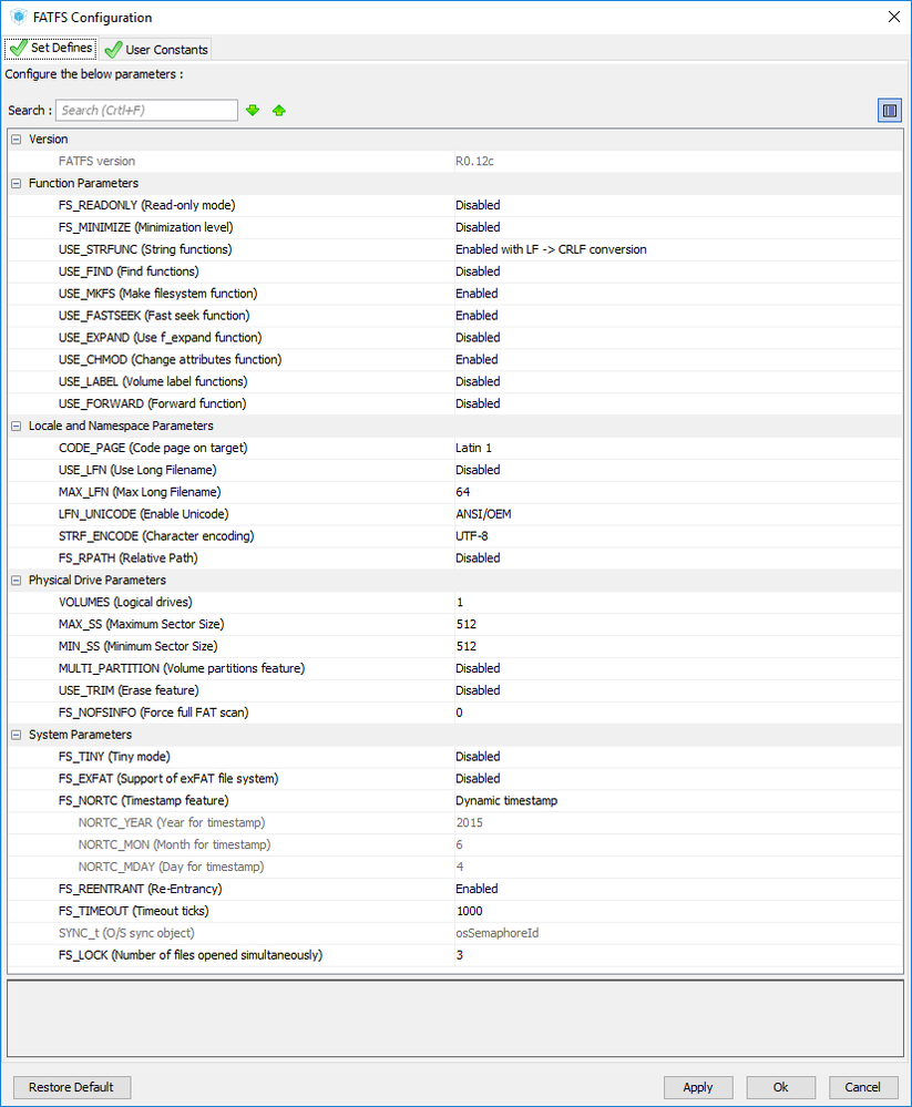

In CubeMx, when the option USE_LFN is enabled, the code generator doesnt generate all necessary code. The missing files are supposed to be in this directory:
Middlewares\Third_Party\FatFs\src\option\
There are no unicode.c and ccXXX.c files (the last depends on the CODE_PAGE). Because of that, no unicode support functions are available:

Posted on March 20, 2018 at 11:56
Hi
Przenioslo.Lukasz
I have tried to reproduce, but without knowing much about the configuration and the scenario (new project? old one imported?), I do not know and cannot really figure out what could be the source of the issue.
Would be great to get more information so that we can investigate where the issue is.
- OS: Windows / Linux / Mac OS ?
- CubeMx version: 4.0 (or older) ?
- STM32 series/mcu used ?
- Fatfs parameters settings (USE_LFN? CODE_PAGE? LFN_UNICODE? ...) ?
On my side, using CubeMx 4.0, Windows OS 7, F4 series (supporting FatFS R0.12c in CubeMx), playing with some (USE_LFN=3, CODE_PAGE=Japanese, with/without LFN_UNICODE), and creating new project for IAR Ewarmand forTrueStudio as well, files are copied in the option folder created and the functions you mention are found in syscall.c (ff_memalloc and ff_memfree) and the ccXXX.c file, cc9c file in my example, for Japanese mode (
ff_wtoupper and ff_convert).
Regards,
Fred
Posted on March 21, 2018 at 11:37
Hello Fred,
Let me write everything here:
- OS: Windows 10 64 bit
- CubeMx vesrion: 4.23.00
- MCU used: STM32L452VE
- Fat parameters:
I am generating the code for truestudio.
