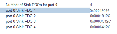

I am using a NUCLEO-G071RB dev board with a X-NUCLEO-SNK1M1 expansion board to create a USB PD sink application.

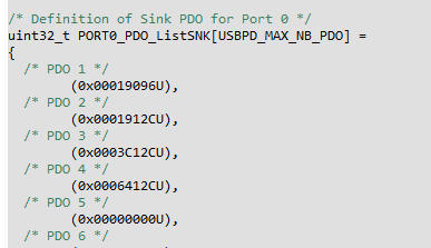

I downloaded the project files from this GitHub repo x-cube-tcpp/Projects/NUCLEO-G071RB/Applications/USB_PD /SNK1M1_Sink/ and only changed the PDOs from the default to the following:
After building and flashing the firmware to the dev board, I used a TI TPS65982-EVM board to supply the power to the SNK1M1 expansion board's USB-C cable. I also have the VBUS lines on the expansion board connected to a load capable of 150W in order to see the power output. I configured the TPS65982-EVM to be capabilities to 5V @ 3A 12V @ 3A and 20V @ 3A and the PDOs in my usbpd_pdo_defs.h file match this.
However, I am not able to get any other voltage besides the default 5V @1.5A UNLESS I manually add in the PDO using the STM32CUBE-Monitor application.
I suspect the PDO's I assigned are not being properly pulled, but am struggling to see why that could be.
Thanks in advance.

Hello @jvl97
We do not reproduce the issue with your PDO and a commercial type-c power supply.
Please, could you share your modified project with us ?

Hello @jvl97
It could be interesting to have a trace with CubeMonitor-UCPD to see the protocol exchanges : there could be the reason of the pdo request rejection.
Perhaps you filled the PDO field structure, but some code is missing in the request message ?
