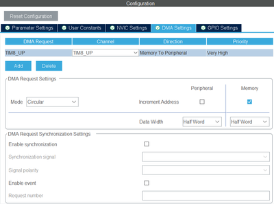

I'm relatively new to STM32 and it's my first time working with DMA so this will probably be a very basic question.
I'm using STM32G474 and I want to have 3 channels of advanced timer TIM8 working in "PWM generation CHx CHxN" mode. At a later stage I'm looking to run FOC on them, but for now I just want to change the duty cycle of each channel period by period, by reading the duty cycle for the next period from a predefined table and transferring the duty cycle value using circular burst DMA to update all 3 channels at the same time without software overhead.
These are my DMA settings for TIM8 in the ioc file

Hi @Dor_RH
Unfortunately the TIM_DMABurst is not quite what I'm looking for. If I'm seeing right that project uses DMA in Normal mode, I'm looking to use it in Circular mode. I see that the example project uses HAL_TIM_DMABurst_WriteStart, same as me. In the comment above the function it says
* @note This function should be used only when BurstLength is equal to DMA data transfer length.
This lead me to believe I'm not using the right function, and I found HAL_TIM_DMABurst_MultiWriteStart, I set the corresponding data buffer length and started seeing the PWM outputs change the duty cycle for all 3 channels.
