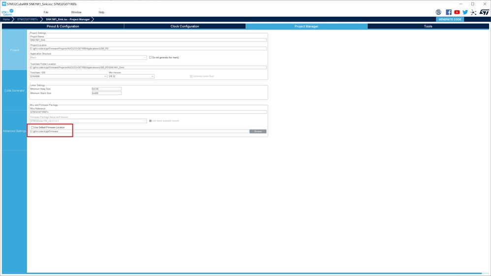

Hi @Yohann M.​ , I downloaded the new x-cube-tcpp package but I can't seem to find any instructions on how to install it. I tried to use the CubeMx import "from local" button in the software packages manager window but it gives an error that it doesn't recognize the package. I guess it's a stupid question, but how am I supposed to use this package with cubeIDE/cubeMX?
Thanks,
Nathan
Hi @NathanWolcott​
This package is not part of the X-CUBE package downloaded directly through CubeMX.
You should open directly IOC files provided in each USB-PD application like:
https://github.com/STMicroelectronics/x-cube-tcpp/blob/main/Projects/NUCLEO-G071RB/Applications/USB_PD/SNK1M1_Sink/SNK1M1_Sink.ioc
When you open it CubeMX, you should see that it is linked to your package you uploader on your laptop like this:
Regards,
