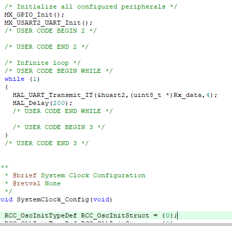

Transmitter code.
uint8_t Rx_data[]={1,2,3,4};
while (1)
HAL_UART_Transmit_IT(&huart2,(uint8_t *)Rx_data,4);
HAL_Delay(200);

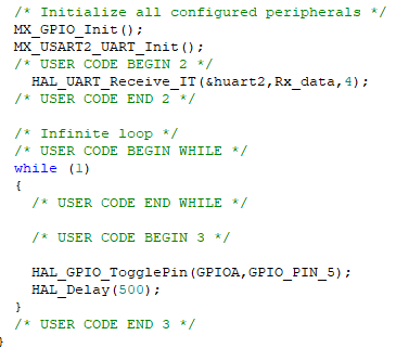

Receiver code
/* USER CODE BEGIN 0 */
//uint8_t Rx_data[10];
uint8_t Rx_data[4];
void HAL_UART_RxCpltCallback(UART_HandleTypeDef *huart)
HAL_UART_Receive_IT(&huart2,Rx_data,4);
/* USER CODE END 0 */
MX_GPIO_Init();
MX_USART2_UART_Init();
/* USER CODE BEGIN 2 */
/* USER CODE END 2 */
/* Infinite loop */
/* USER CODE BEGIN WHILE */
while (1)
/* USER CODE END WHILE */
/* USER CODE BEGIN 3 */
HAL_GPIO_TogglePin(GPIOA,GPIO_PIN_5);
HAL_Delay(500);

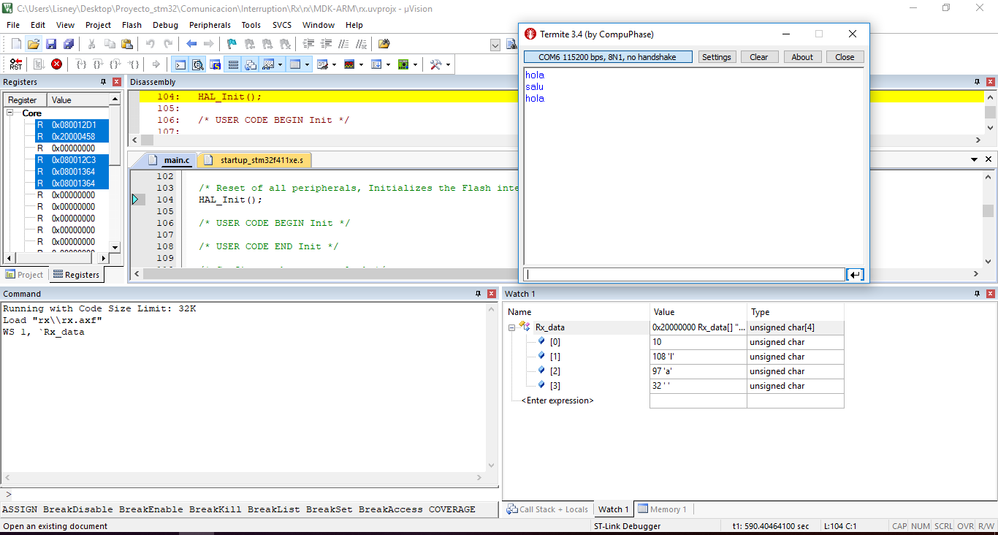

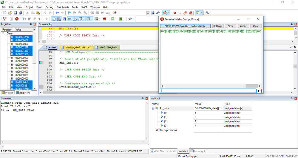

Then I use two different computers to load each part of the code, the transmission and reception and first execute the reception so that it is ready to receive and then the transmission code, however in the reception debbug I observe absolutely nothing.
When I run and test the transmitter code, I test it in this way.
When executing and testing the reception code, I test it in this way

‎2019-03-08 4:12 AM
Callback is done within the interrupt! That is where you get an incoming byte and you ve got to do something quick about it. Activate the IT from the main loop, add a 100ms delay, then transmit... For test
